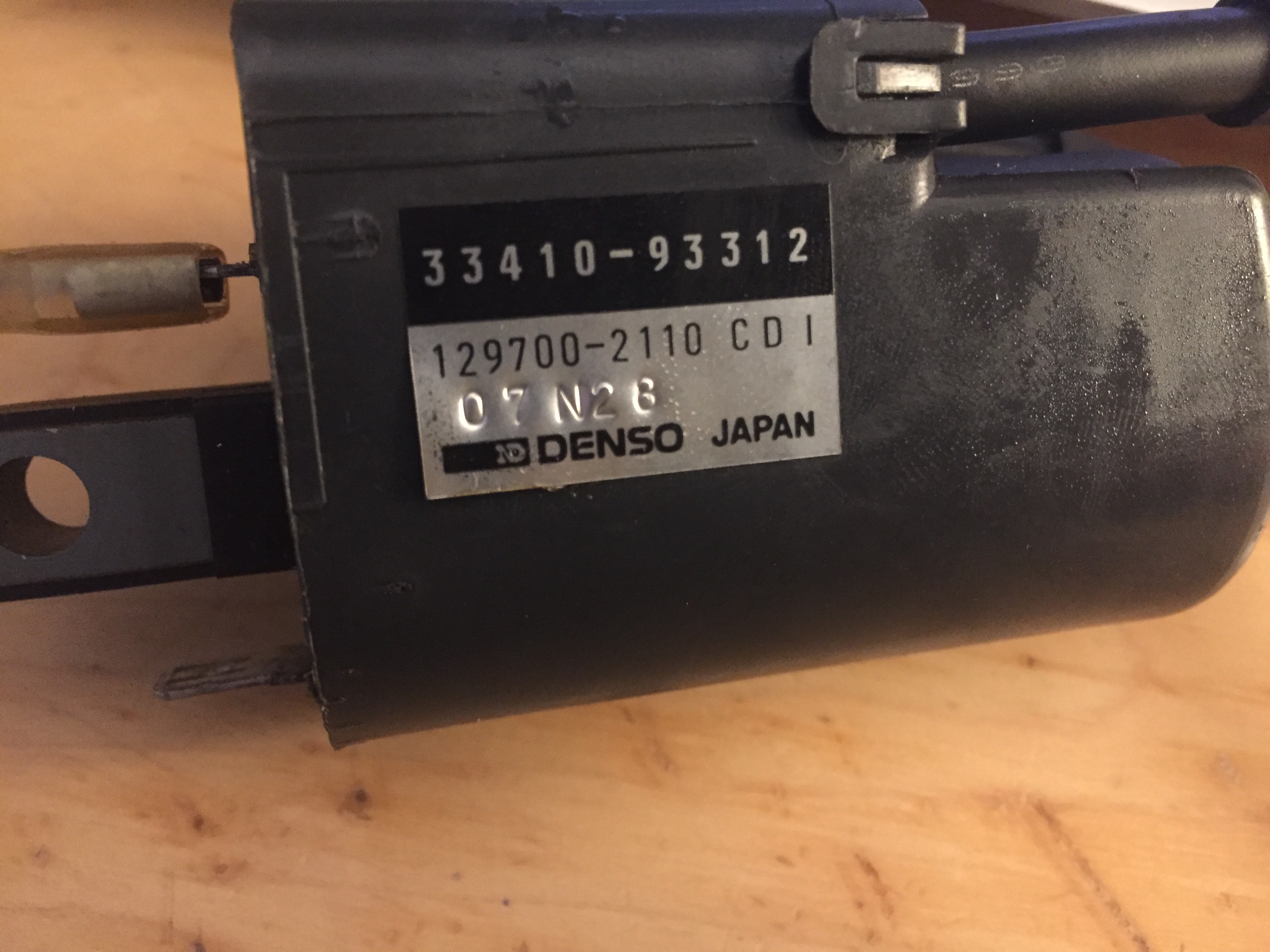

      rco
        Is there a manufacturer code on the coil itself ( different from the Suzuki number)? Most of the Japanese outboards I have worked on use Nippon Denso or Mitsubishi ignition parts that are common to many manufacturers and engine types. You could also get a resistance reading from a known good coil and sub one that has the same specs and mounting bracket.
        If it the one I am thinking of with the single orange wire and dual towers, it is the same as the ignition coil used on most Arctic cat snowmobiles from the 70’s through the early 2000’s.

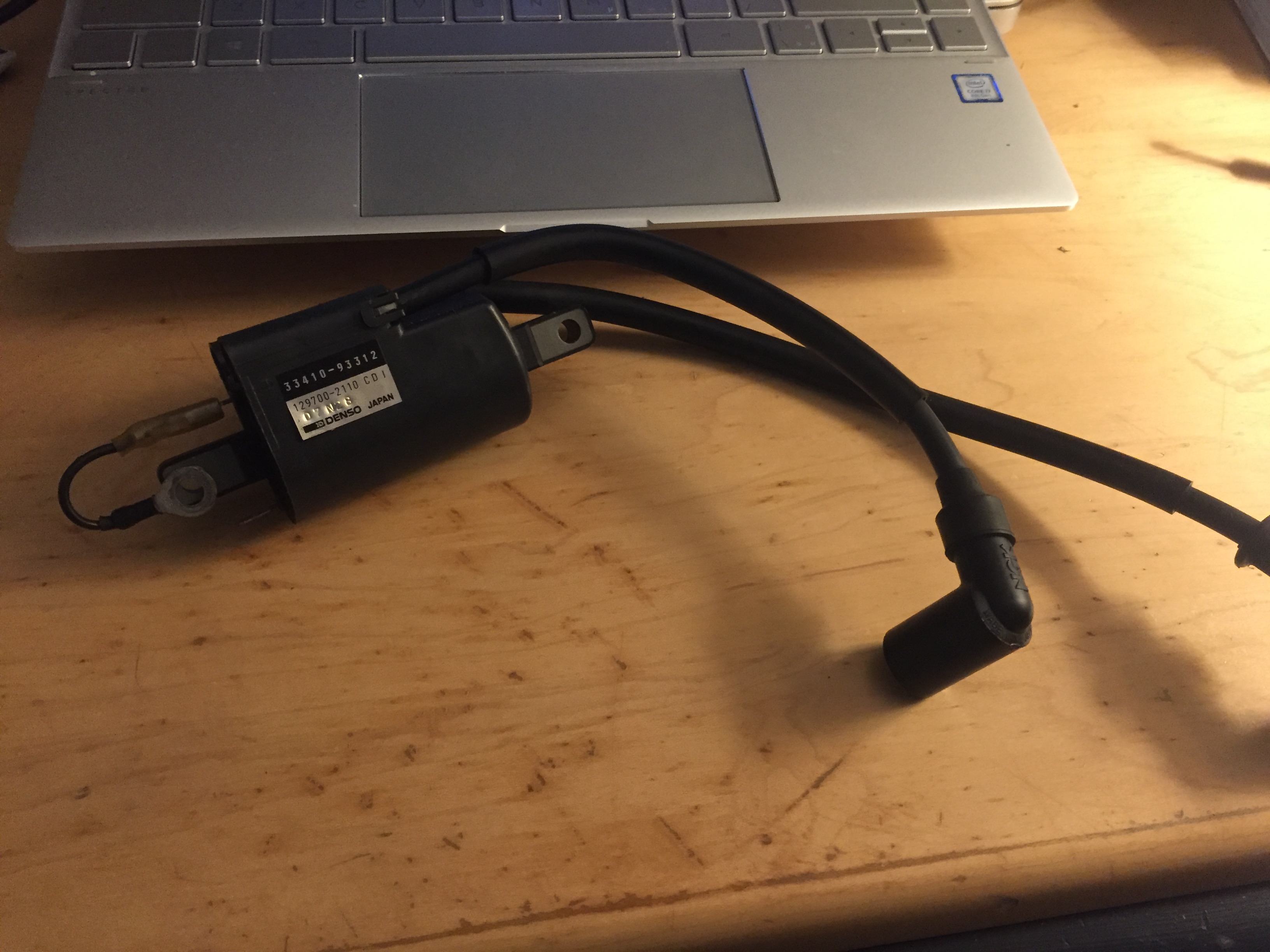

          #84508
          shane-r13
            This is my current coil.

              #84526
              David Stanton
                quote Shane.R13:
                This is probably a silly question. But can I use a coil that matches up but says 12V not CDI on it? Not likely I’m sure but figured someone may know the definite answer.
                Shane
                That may or may not work. 12 Volt battery ignition coils are different from modern CDI coils, although back in the 1960s /1970s there were CDI conversion units for cars that used the original 12 Volt coils that came with the car. The "Delta Mark 10" CDI was one of the most popular.
                These units converted 12 volts to approx 400 volts and used Capacitive Discharge (CDI) to dump pulses into the coil primary. I had two of them in cars back then.
