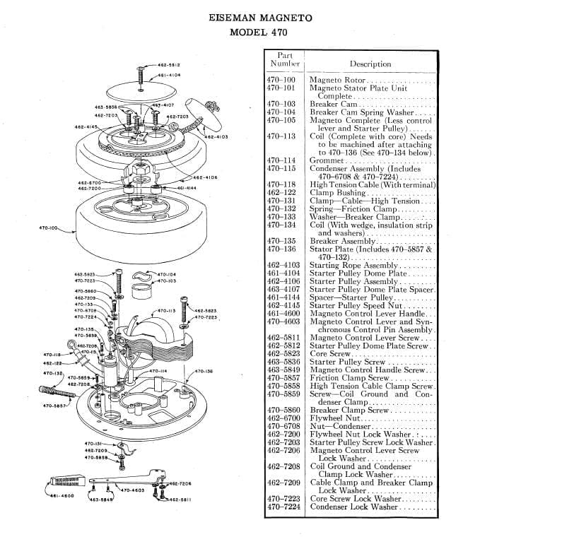

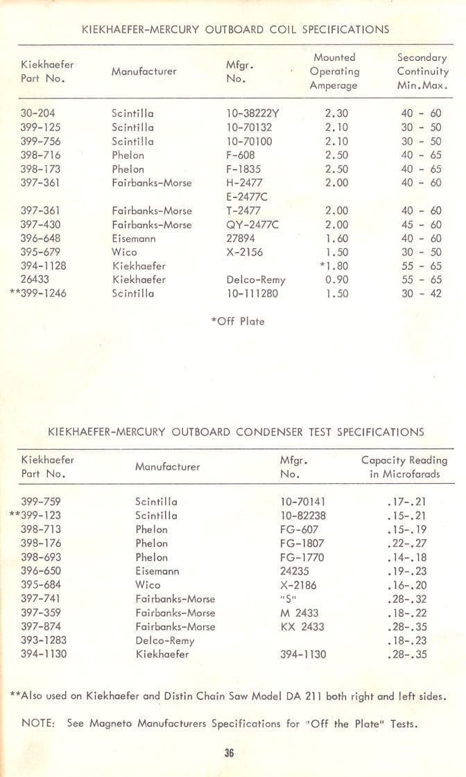

              According to the Merc-O-Tronic manual, Mercury also used an Eiseman mag at some time in their history. Don’t know if it was the same one, or which Mercury.
              Scott-Atwater part number for Eiseman points is 470-135. Now all you have to do is find a Scott-Atwater dealer. Yeah, right.
              Page-36-Keikhaefer-Mercury-Coils-Condensers
              Eiseman-Magneto
