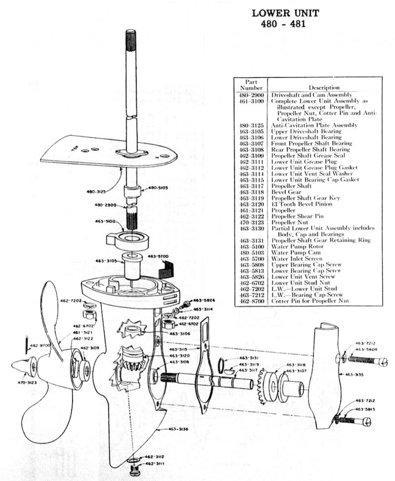

        Is your’s a rotor style or rubber vaned?  Does it look like the one in the diagram?
        There is a Member here who makes impellers.  You can Google “Brian Wilcox impeller” and see how to contact him.
