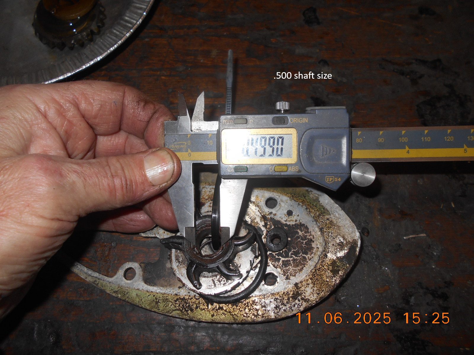

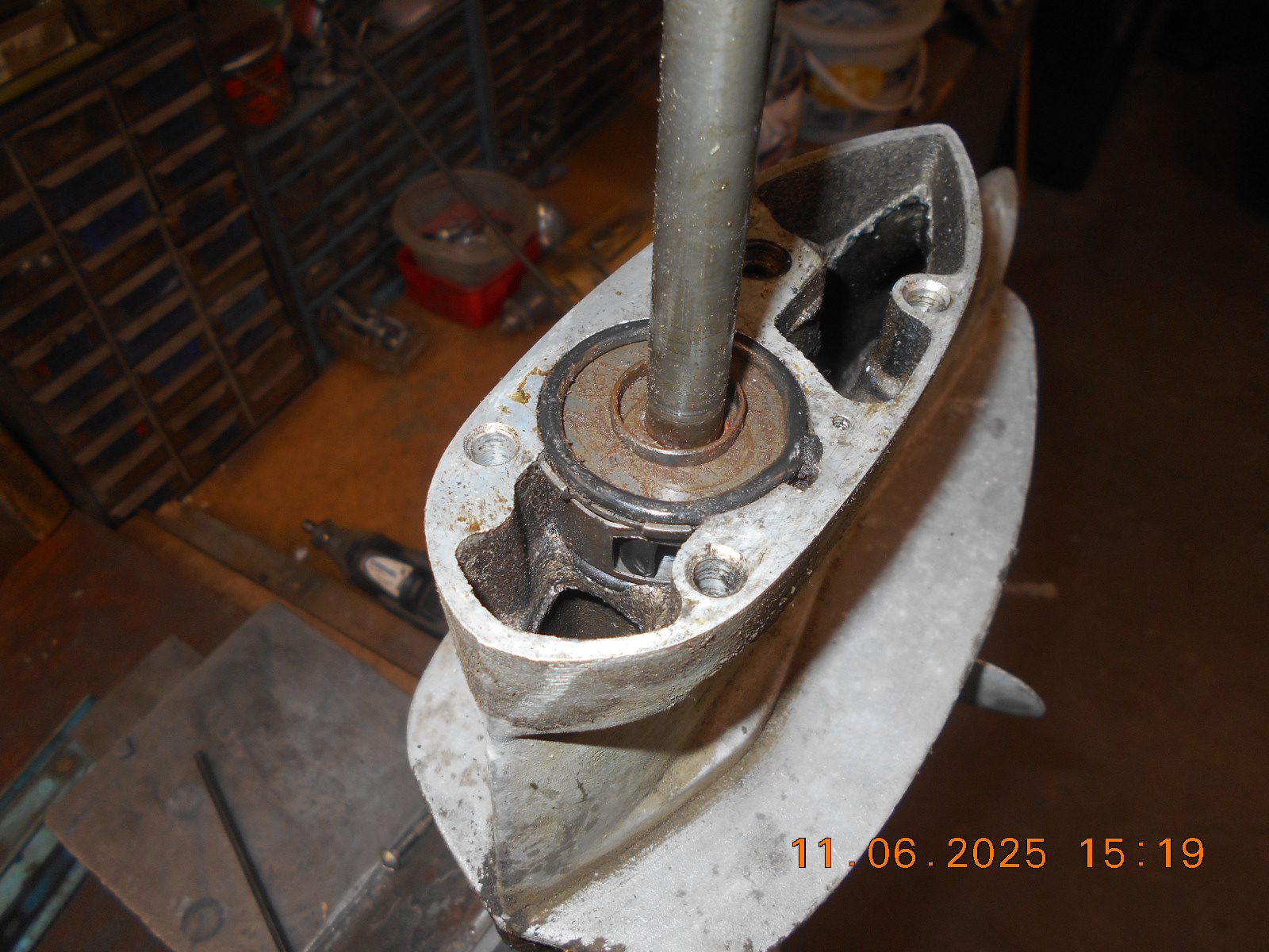

      Wondering if anyone knows an impeller number that might fit
      the subject motor. It’s a “non-bailer” motor.
      I forgot to measure the height / depth of the impeller, but
      will do so today.
      Thanks.

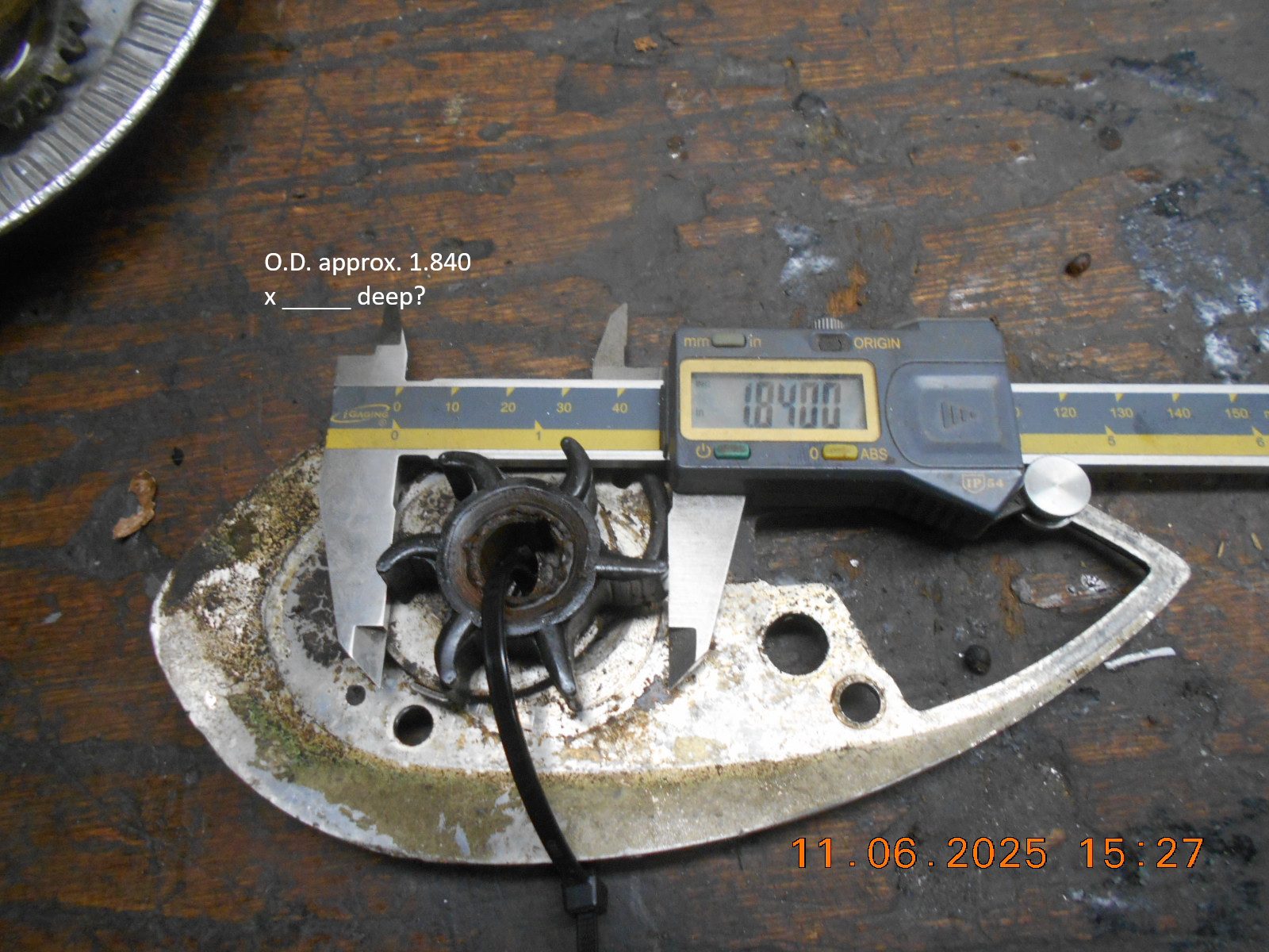

        I re-measured the old impeller in the 10 hp Corsair, and it’s
        .500 shaft
        1.864 OD
        .580 ish thick
        I found one close in diameter in my stash, but it was way too thin.
        Hopefully someone has a proven impeller number that will work.

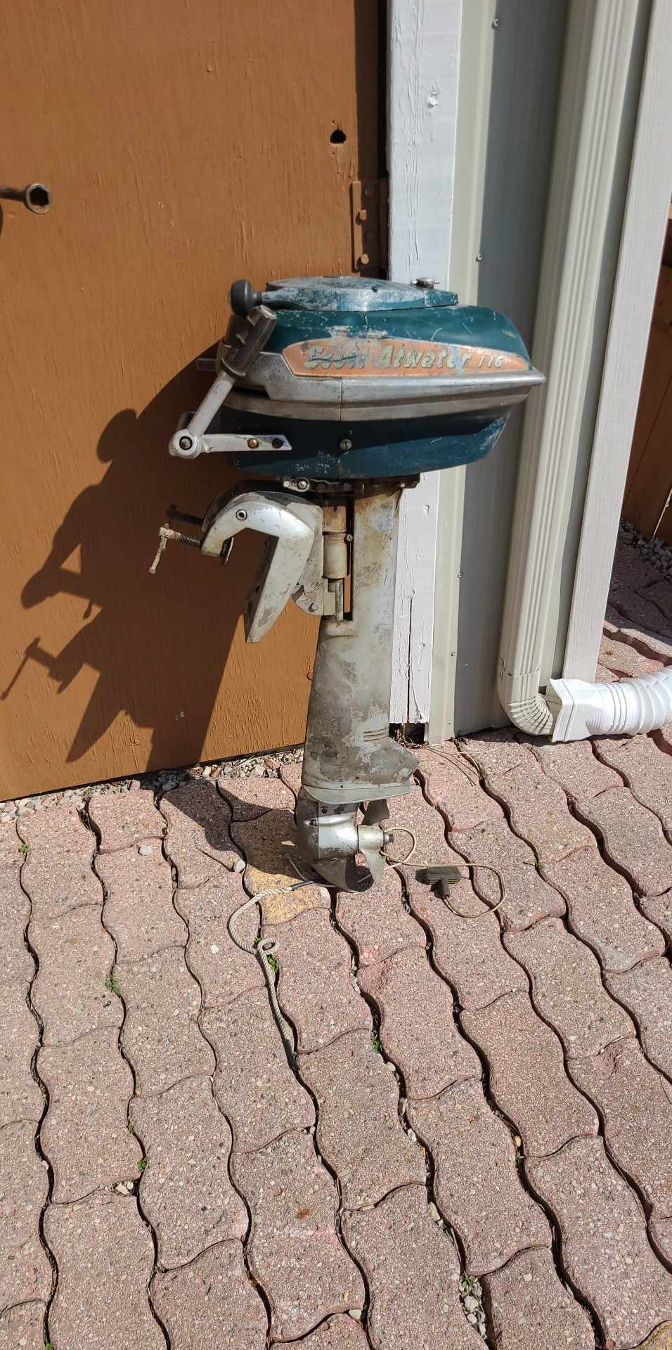

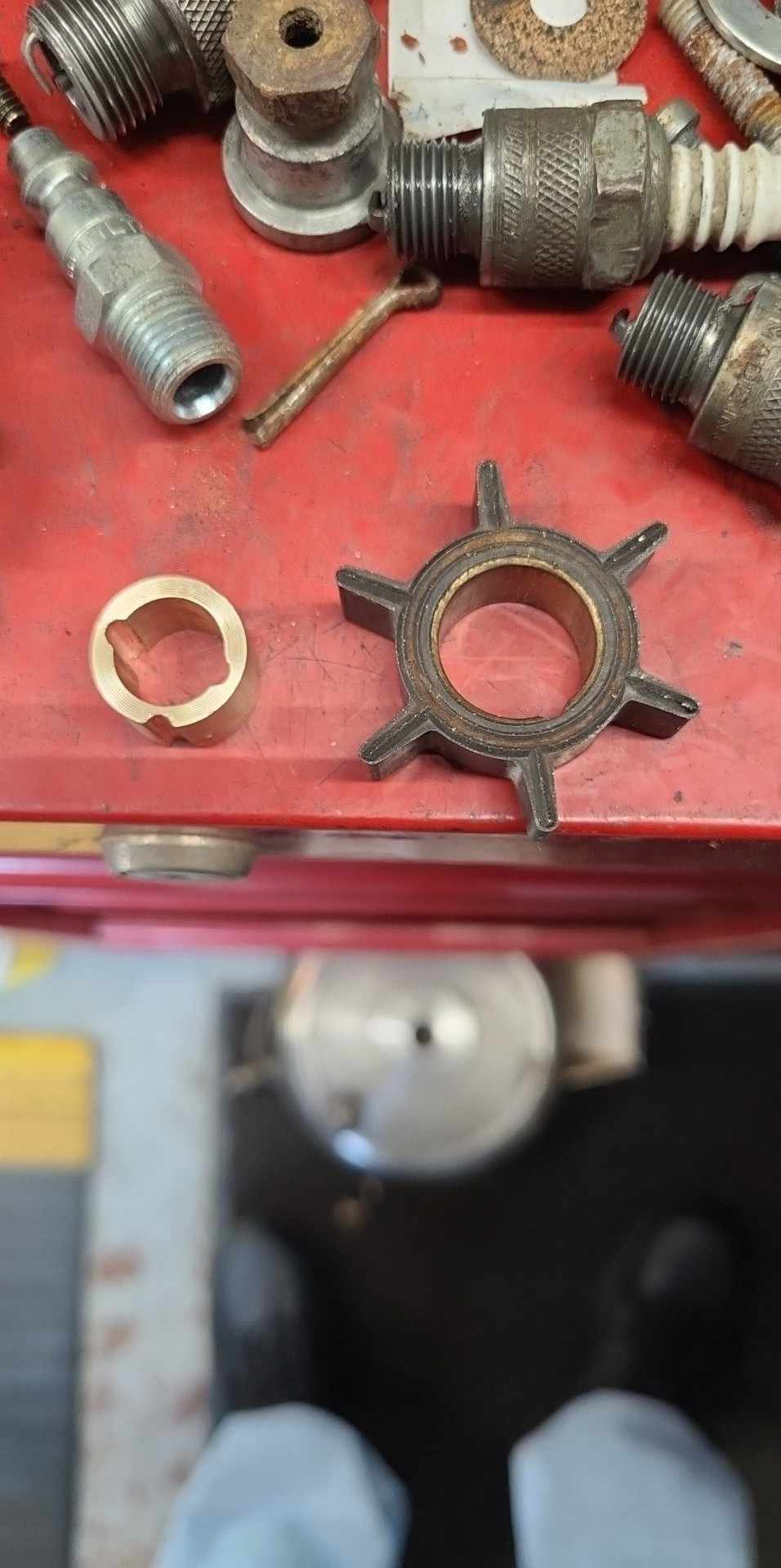

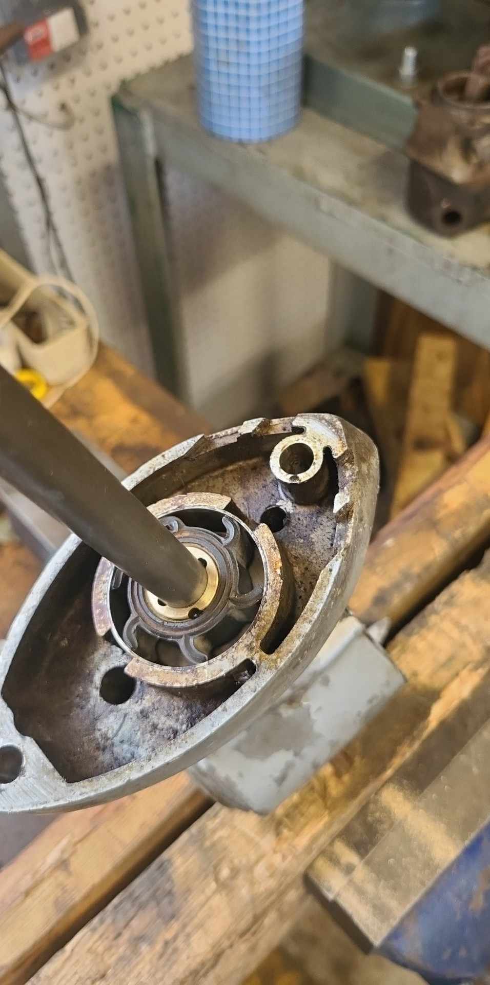

            I used a Merc impeller in a Scott last year. The impeller hub ID was bigger than the driveshaft so I made an adapter hub. It worked real well.

                      I’m digging through my work notes but apparently I didn’t record a part number for what I used. As I recall, it was supposed to fit a KG7.
                      The Scott was a 1949 model 1-16.
