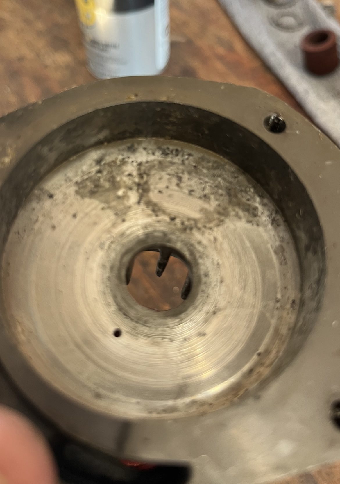

      Should I use this or replace? Pitted but still somewhat smooth

        Tinman, I have reused housings that look like that with no issue on my smaller motors.    I would lightly clean with scotchbrite and use an oem impeller  though if you do.

          I would probably just smooth it up with some light emery and try it out.  How is the SS impeller plate?  Consider replacing the housing/plate if water pump performance is weak..
