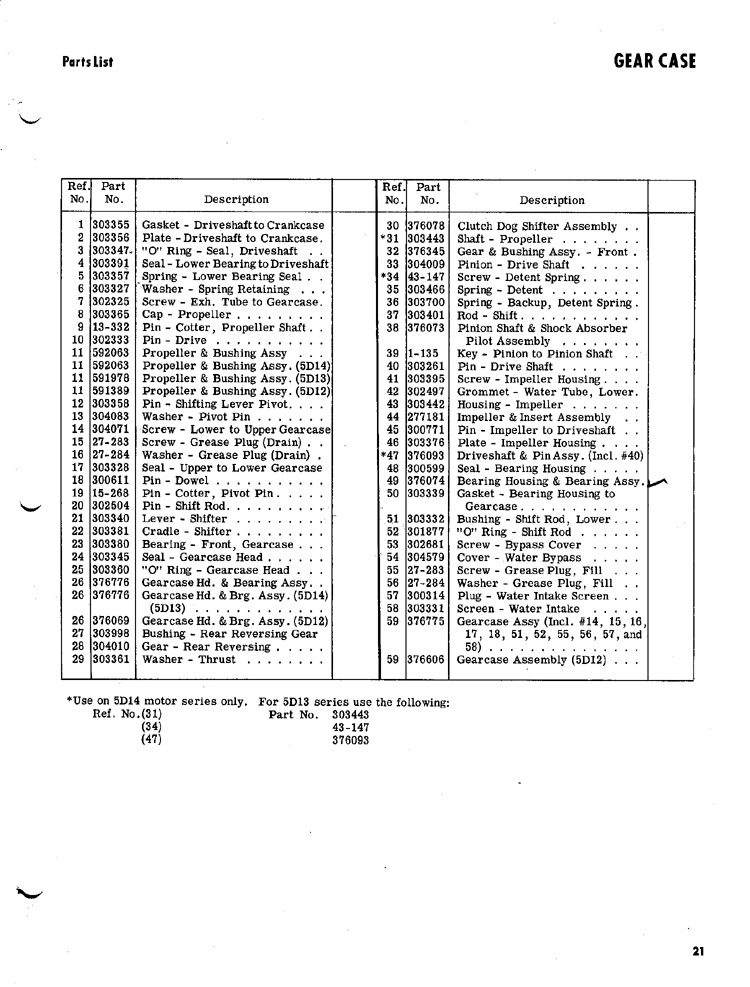

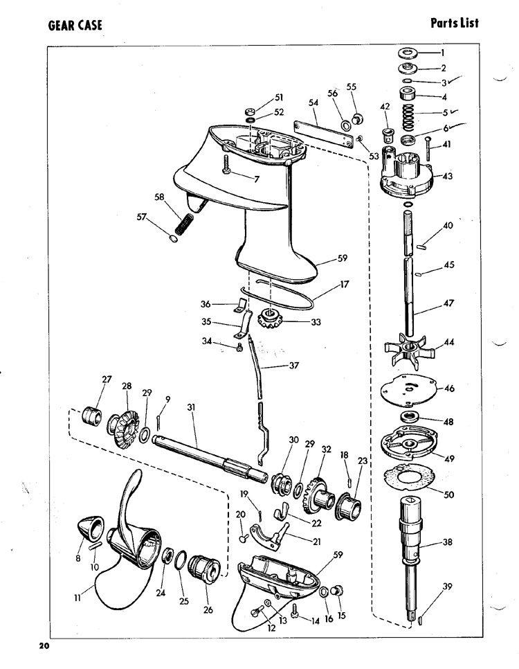

      It looks like you need part# 376074.     You could place a Wanted ad here.  It’s free to place the ad here..
      Pg-20-Gear-Case
      Pg-21-Gear-Case-Parts-List

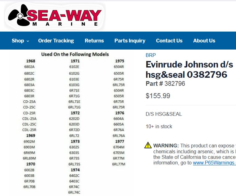

        376074 is now 382796, and it’s available new but you won’t like the price:
        https://www.marineengine.com/newparts/part_search.php?part_num=376074

              If you were going to do what CK mentions there, to help broaden your search for a cheap parts motor, the 50s and 60s 5-1/2 and 7-1/2 HP and maybe the first few years 6 HP use that 376074 bearing housing and the 300599 > 327031 seal.
