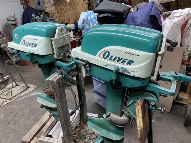

      I’m restoring a 1956 Oliver 15 hp. It uses the same impeller as the Mercury KG7 and Chris Craft Commander. I see the impeller is NLA from the dealer. Are there any affordable options out there? Here is the motor in question. You can follow my progress in the current projects forum.

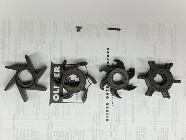

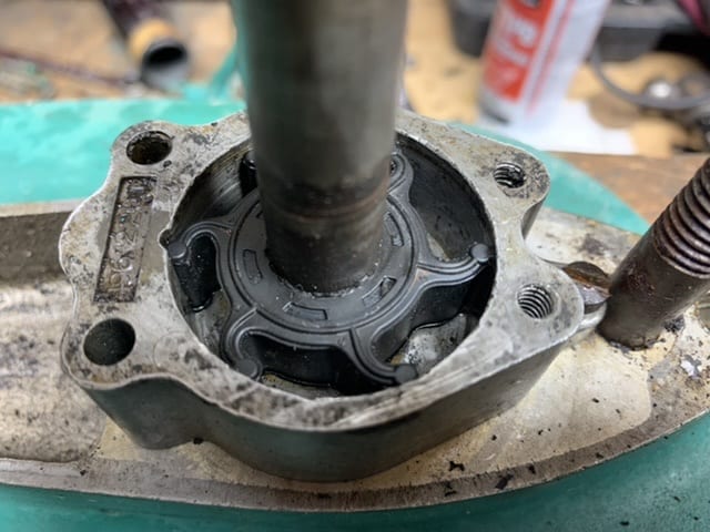

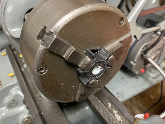

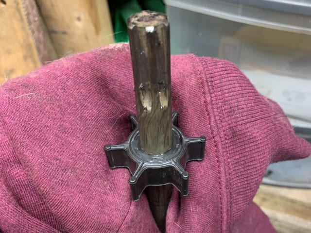

                    So after some experimenting with impellers I have found what I think is an affordable solution that should be available for awhile. The impeller fits perfectly with the exception of the ID. The Oliver driveshaft is only 9/16”, which makes it the same as the KE7 not the KG7 as I originally reported. The hub material is hard plastic and is easy to file or machine to the correct diameter. I will likely switch the impeller key to an OMC style instead of the original pin style.
                    Honda BF8D part #19210-ZW9-013
                    742BFD11-5DF6-4DD6-B9D2-520DD841C305
                    36D5CD31-8DE7-45E6-867D-D66681DBF394
                    0B3735F2-3FD7-4A39-B25A-C8DFD2B3D7CD
                    For those of you interested in the details of this saga, I first attempted to find another useable impeller from the parts bin. I found that the Martin 100 impeller fits the driveshaft and housing perfectly, but would need some modification to the driveshaft as the key is different. This was never really a viable future solution since I can’t go to the Martin dealer down the street whenever I need another. The same can be said for the Mercury KE4/KE7/Mk7 impeller. The Scott-Atwater 7.5-10 hp impeller fit except for the ID. Knowing that the Honda impeller is a suitable replacement for the SA I chose to pursue it. It is not a perfect solution, but at $32 CAD it is more affordable than the specialty store options that run $50-70 USD plus shipping.

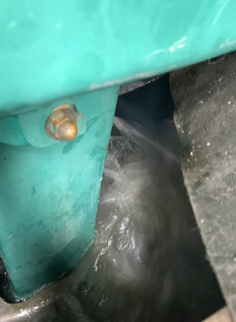

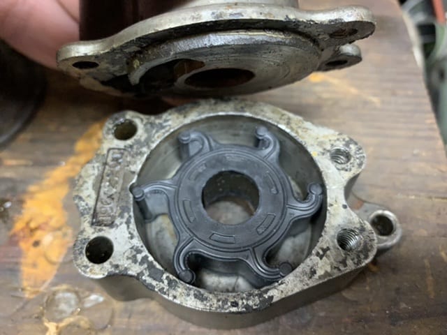

                        Update…water pump mod works great. Again, the part number is as follows.
