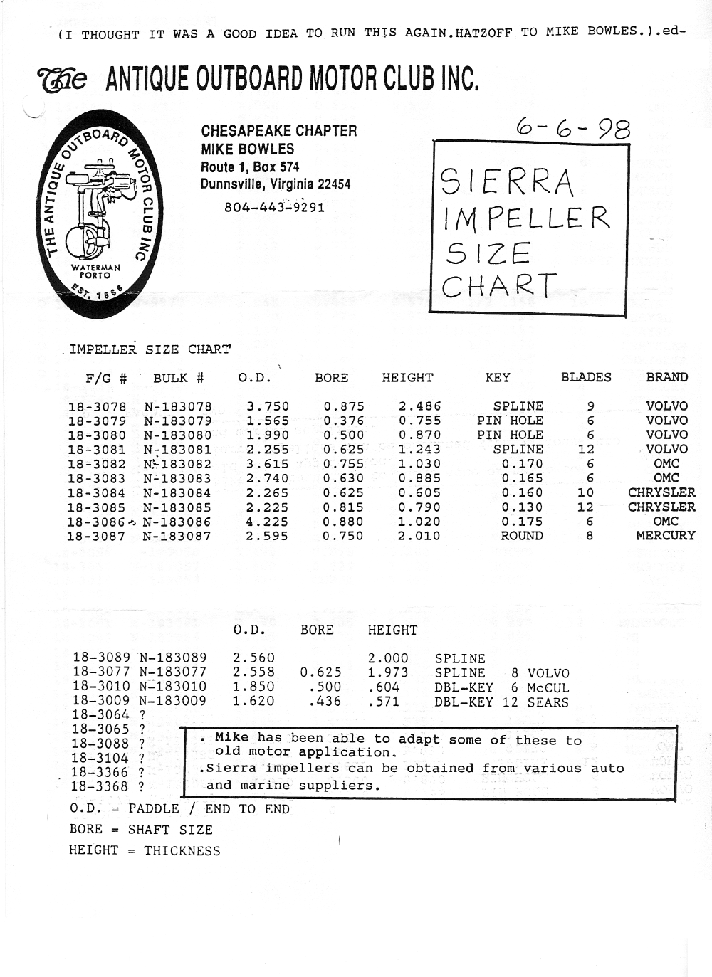

      I know I have seen a chart showing dimensions of water pump impellers but darn if I can find it now. Does anyone have a copy or a link?
      In particular, i am looking for an impeller for a Flambeau, Model 174050, but am probably going to have to find something close and make it work.
      Thanks!

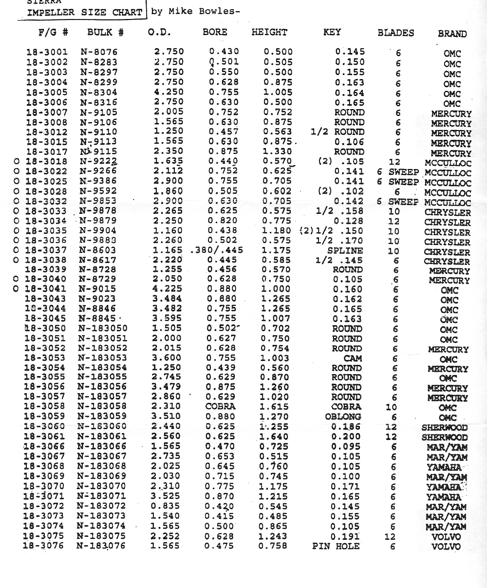

        Here are a few things I found on my computer

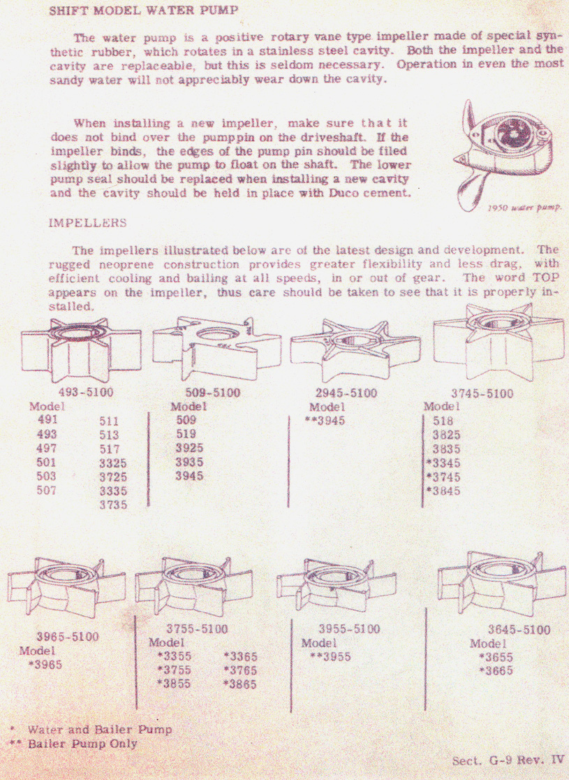

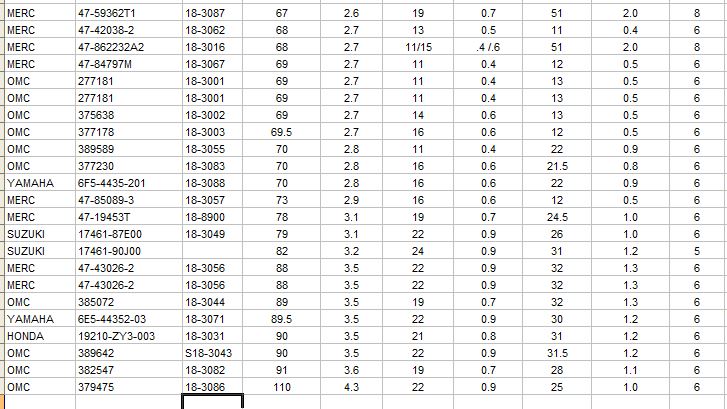

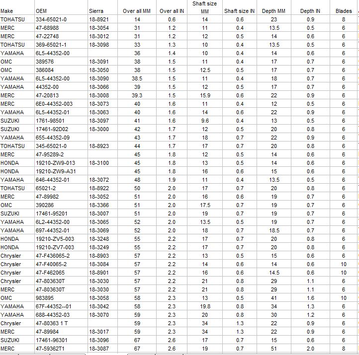

        chris-p
          Few More

            JOSEPH BRINCAT
              There is a typo error on the last size chart for impeller #18-3072 the outside diameter is 1.835 not the 0.835 shown. This was pointed out in a tech article in the latest ( July 2018) issue of the "Outboarder", page 49 … just saying.
              Joe B
