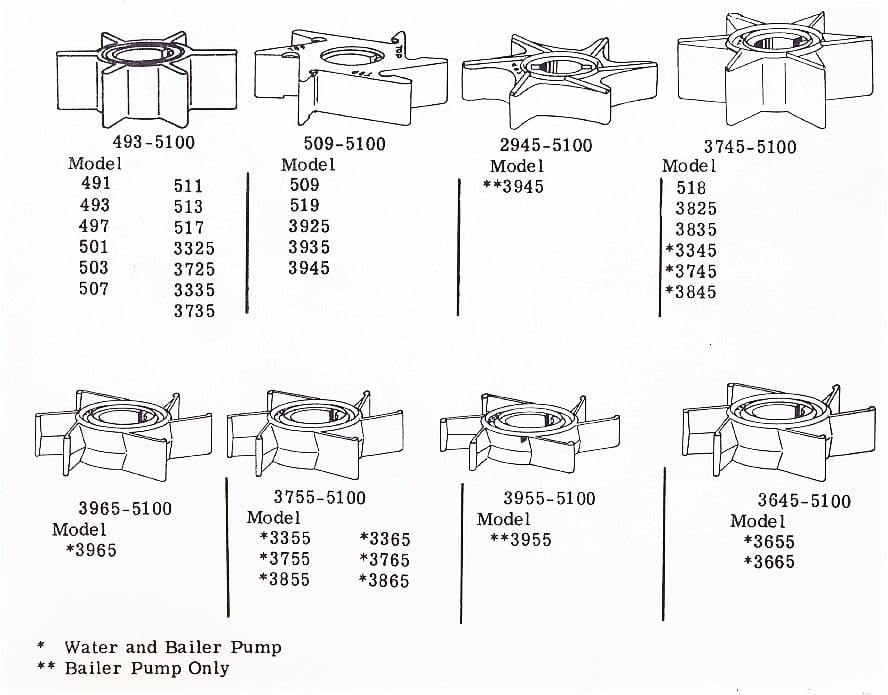

      in search of impeller for Scott Atwater 507 – 5hp, best i could find so far is this https://www.dicarbparts.com/home/534-scott-atwater-5hp-75hp-10hp-water-pump-impeller-kit-ob-3755-5100-new-3785-5100-.html
      Though seems theres some extra orings on there that i believe are for either the 7.5 or the 10hp not my 5hp.
      I was hoping to just get impeller as that is all i need on this restore.

        That is the wrong impeller for your model You want a 493-5100
        #227792
          Scott-Impellers

            Thanks guys I do have the original PN already just trying to locate a suitable replacement or to see if anyone has any they’d sell
