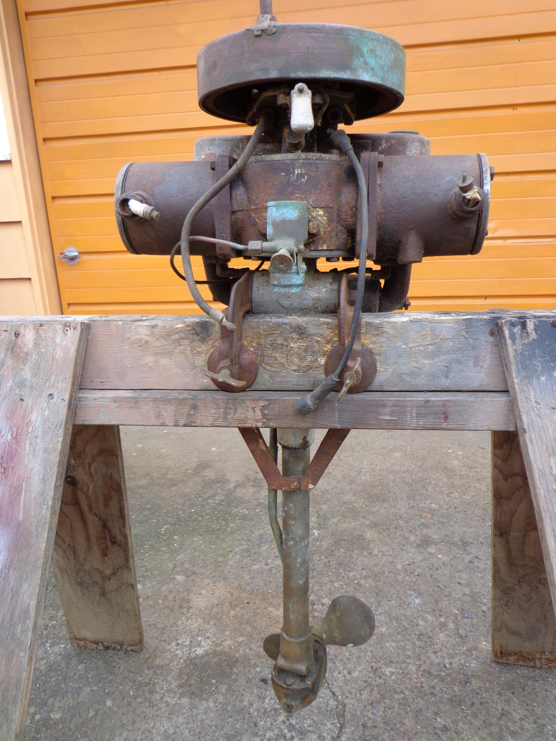

Several years ago a two cylinder, battery-ignition Koban ‘rowboat motor’ followed me home from a local flea market. I could see that it was missing several parts, including the steering mechanism and flywheel, along with a few other parts. I’m toying with the idea of getting it running again.
The flywheel is the large open spoked type, so I think I can find a similar one if I can’t find an original, and I’m thinking a lot of the steering mechanism can be fabricated if worse comes to worst.
I think what might be a fatal factor is that it’s missing both pistons and connecting rods.
Do I have a prayer of finding a set of pistons and conrods?

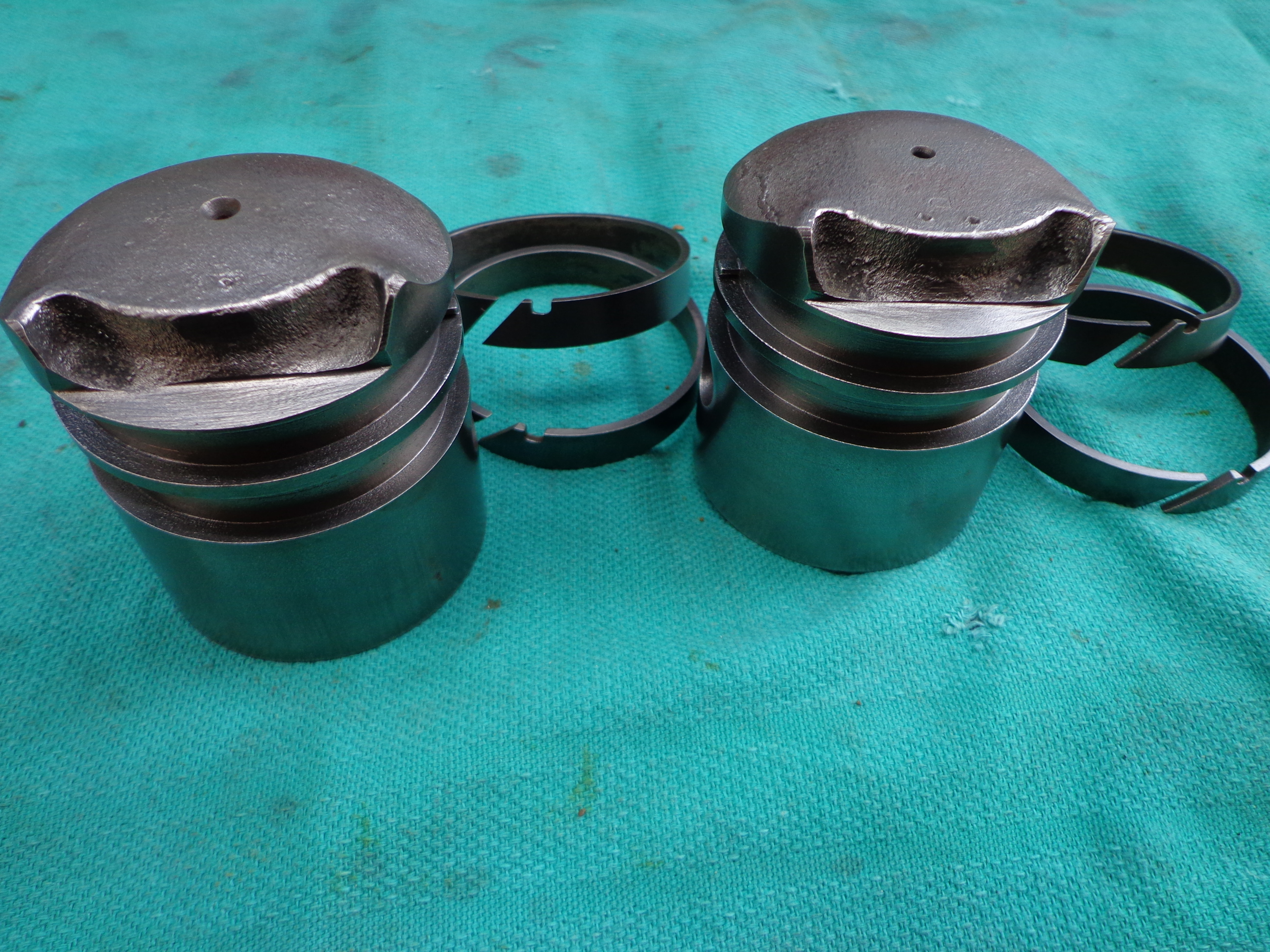

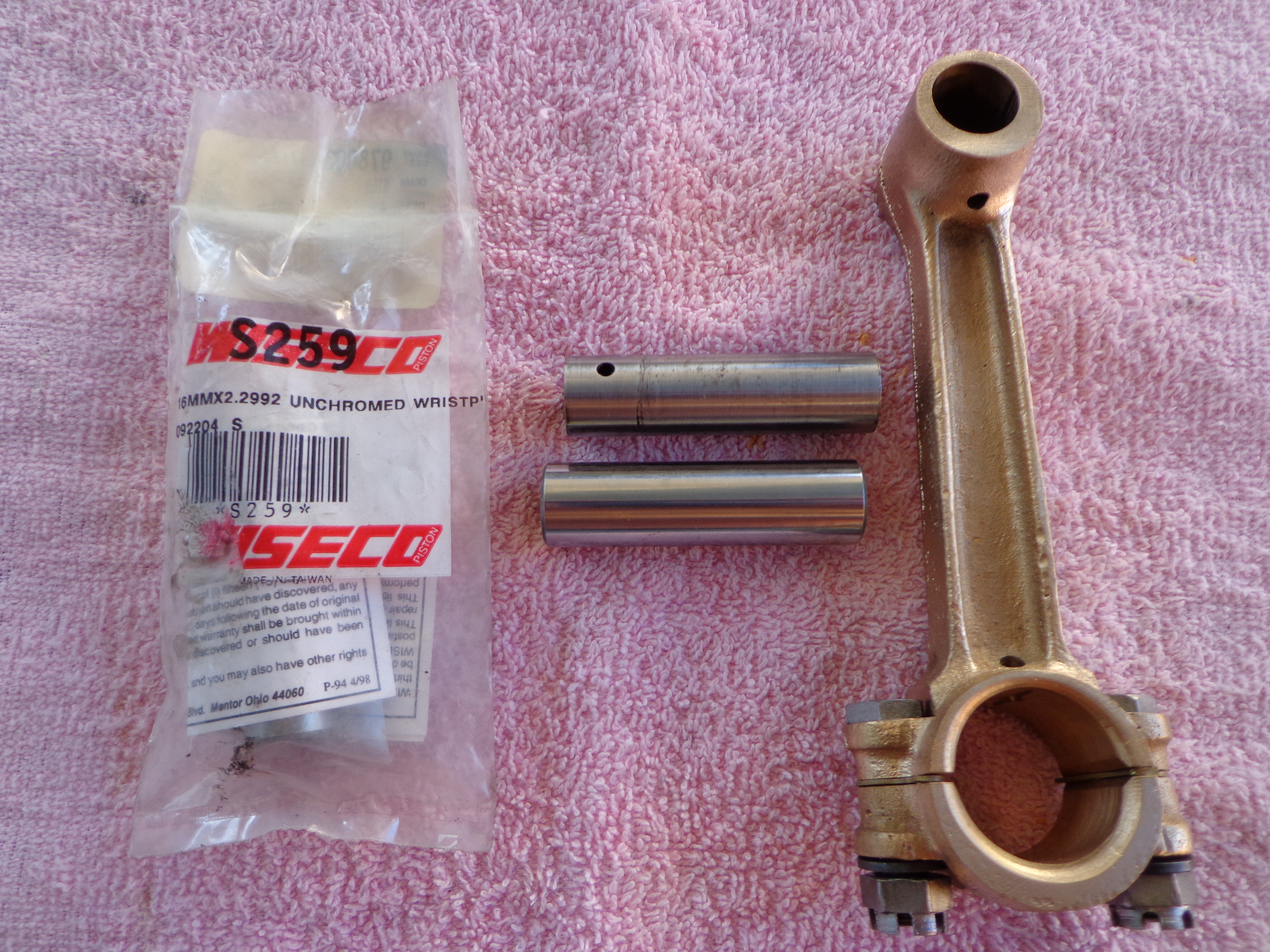

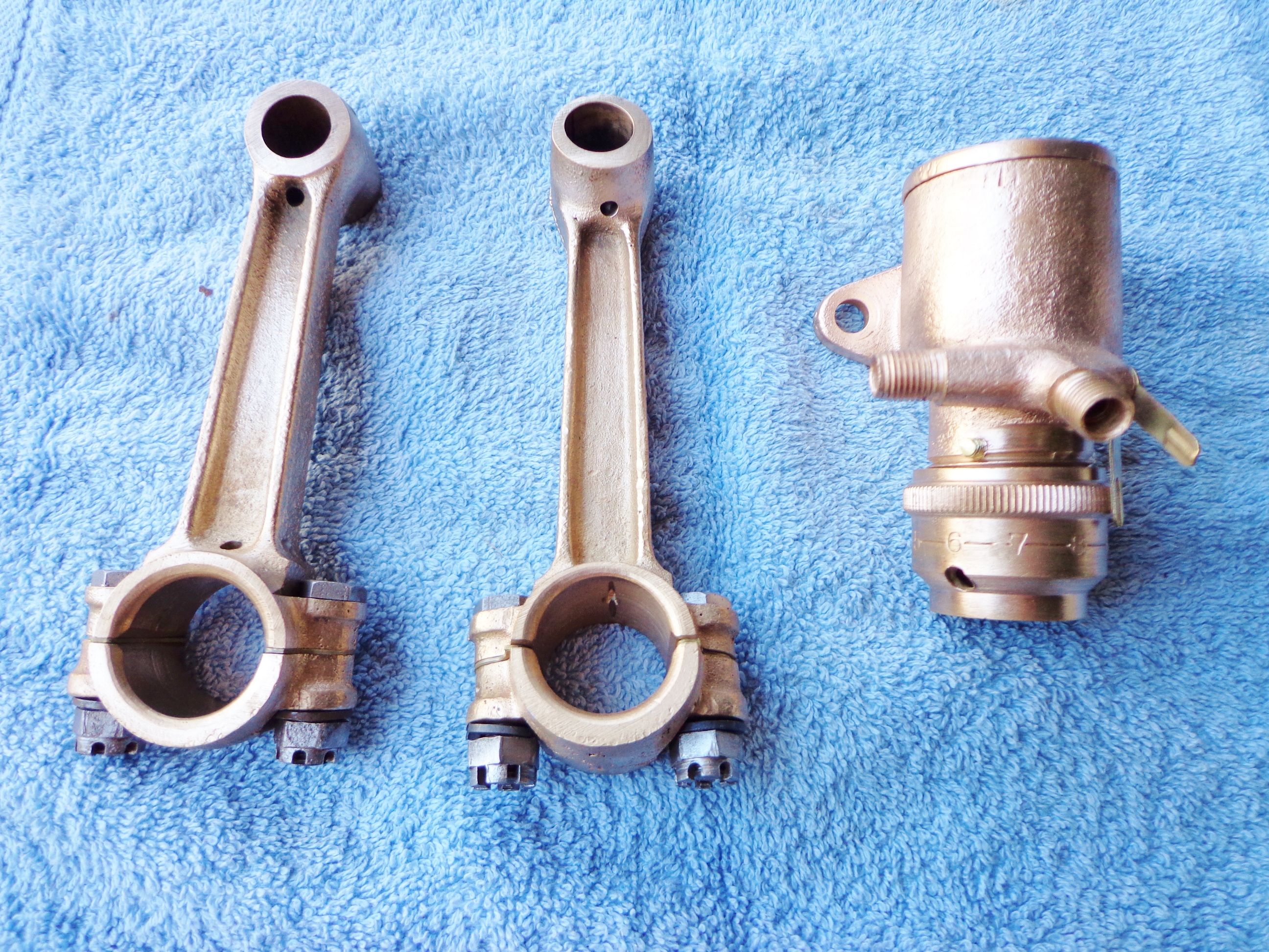

What’s the number on your motor? it should be on top of the crankcase at the front and does it have removable cylinders? Mines missing the brass rudder and linkage to so I might make one out of aluminum when I get it running. Right now the pistons and rods are in the shop getting resized for some new pins I found.
Here’s what your missing pistons and rods look like. The pistons are made of cast iron and have really wide rings on them. 7/16" I think.

S/N is 5177. Cylinders are not bolted, they are a single casting with the crankcase. I’ll post some pictures.
