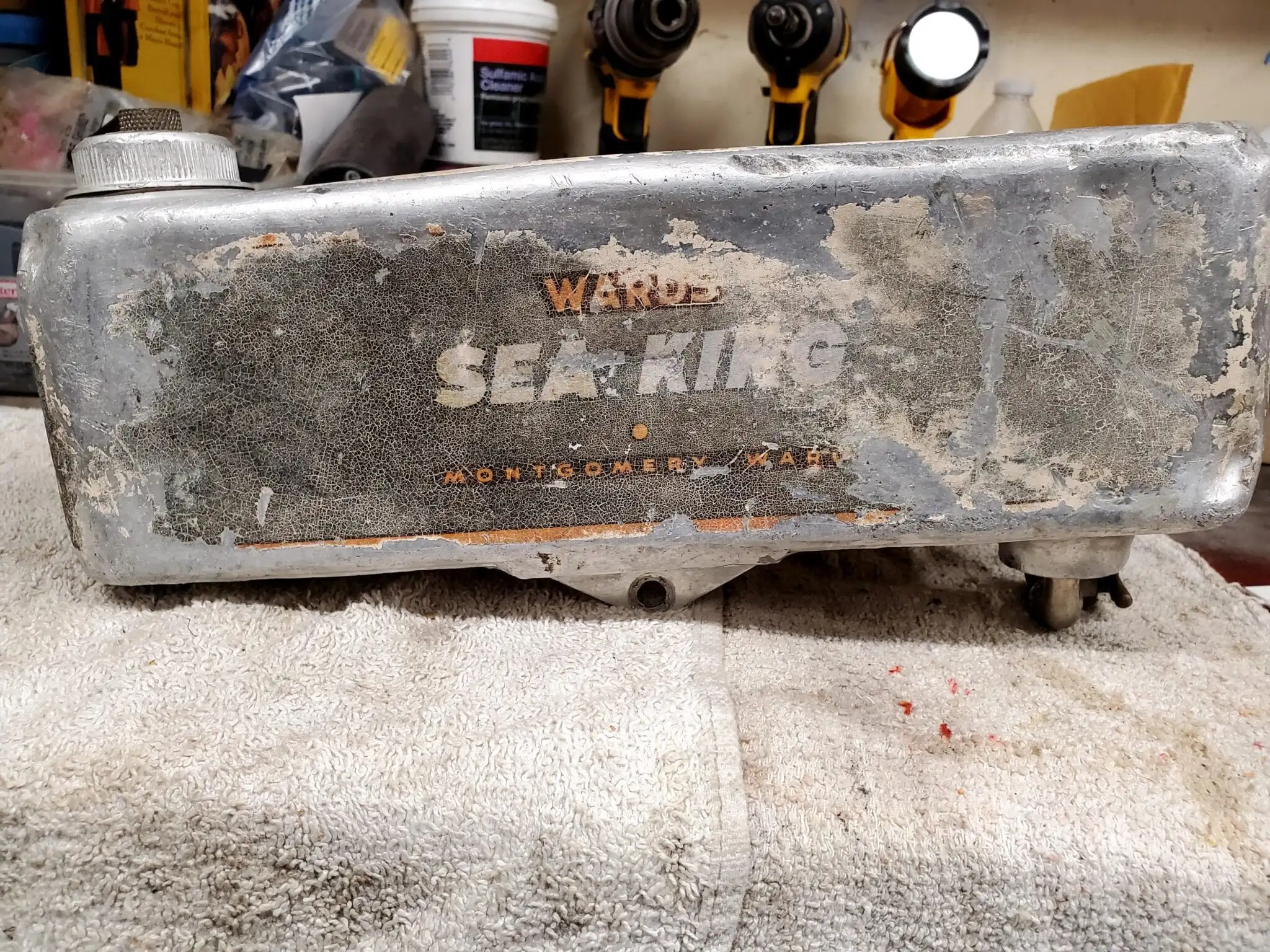

              HARRY D. NICHOLSON
                The 1935 Sea King was 8.5HP. The decal on the ’35 Sea Kings had an all black background. This pic is a 1935 8.5HP Sea King tank. The cylinders on Sea Kings are sometimes different than any Evinrude, sometimes due to different shapes (oval), or tank mounts….SeaKing8.5HP20210620_120200-scaled-1
                #305018
                George Emmanuel
                  Thanks Harry!! That’s what made me ask the question….We had a Sea King 8 1/2 at our meet this weekend with the front tank and it was way different from the 1935.
                  Good to hear from you!
