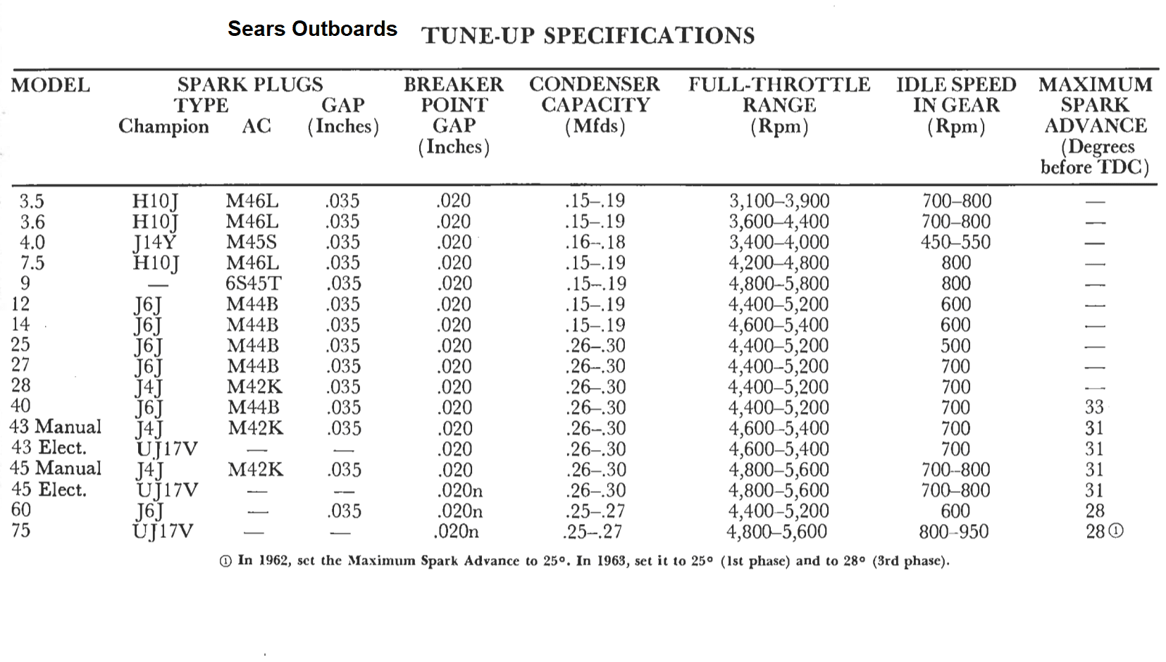

      I just got a Sears 3.5 hp outboard, I think its year is 1968, and need some info on it . Any know the correct spark plug? and the correct fuel mix? I have searched and got different plugs recommended , and mix from 16;1 to 30;1. thanks

        This is the closest I can come.
        Sears
