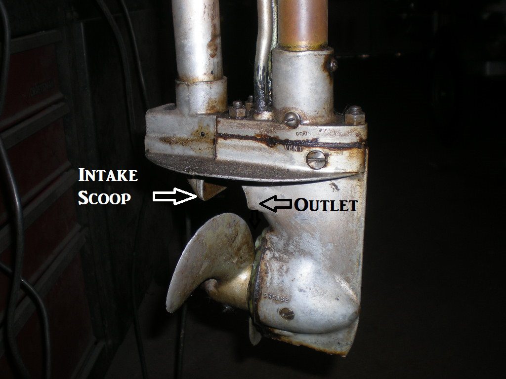

        Your model 110 has basically the same powerhead as the J-25 & the J-65.
        Everything else that bolts to the block, including the tiller assembly, is
        different on the model 100 & model 110. The main difference, in function,
        is how it pumps water. The J motors have a piston pump while your motor
        has another method. Impeller? I’ve never had a 100 or 110.

          My Johnson 100 has the water scoop.

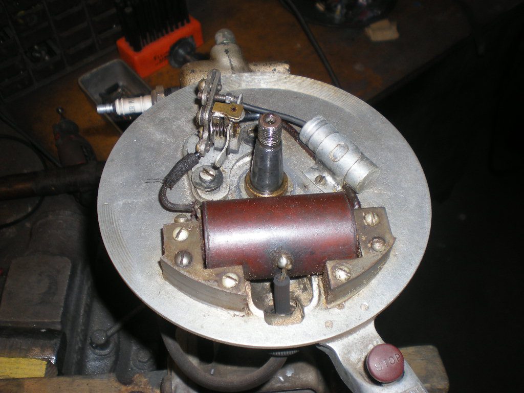

          Simple ignition…….

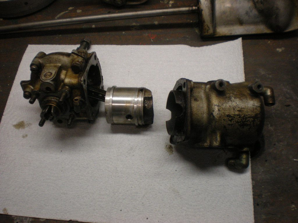

          Three ring piston….

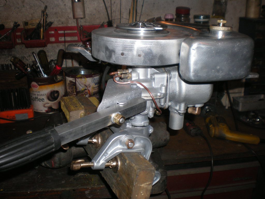

          Mine was missing the tiller handle and triangular bracket
          that it bolts to, so I had to make both.
