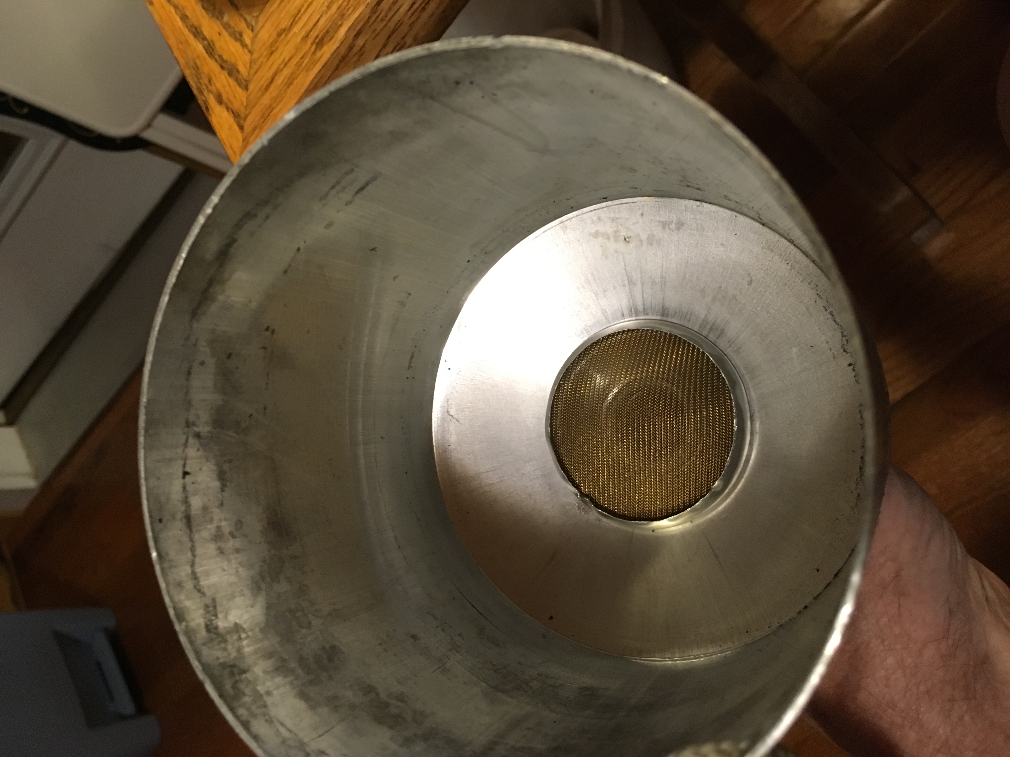

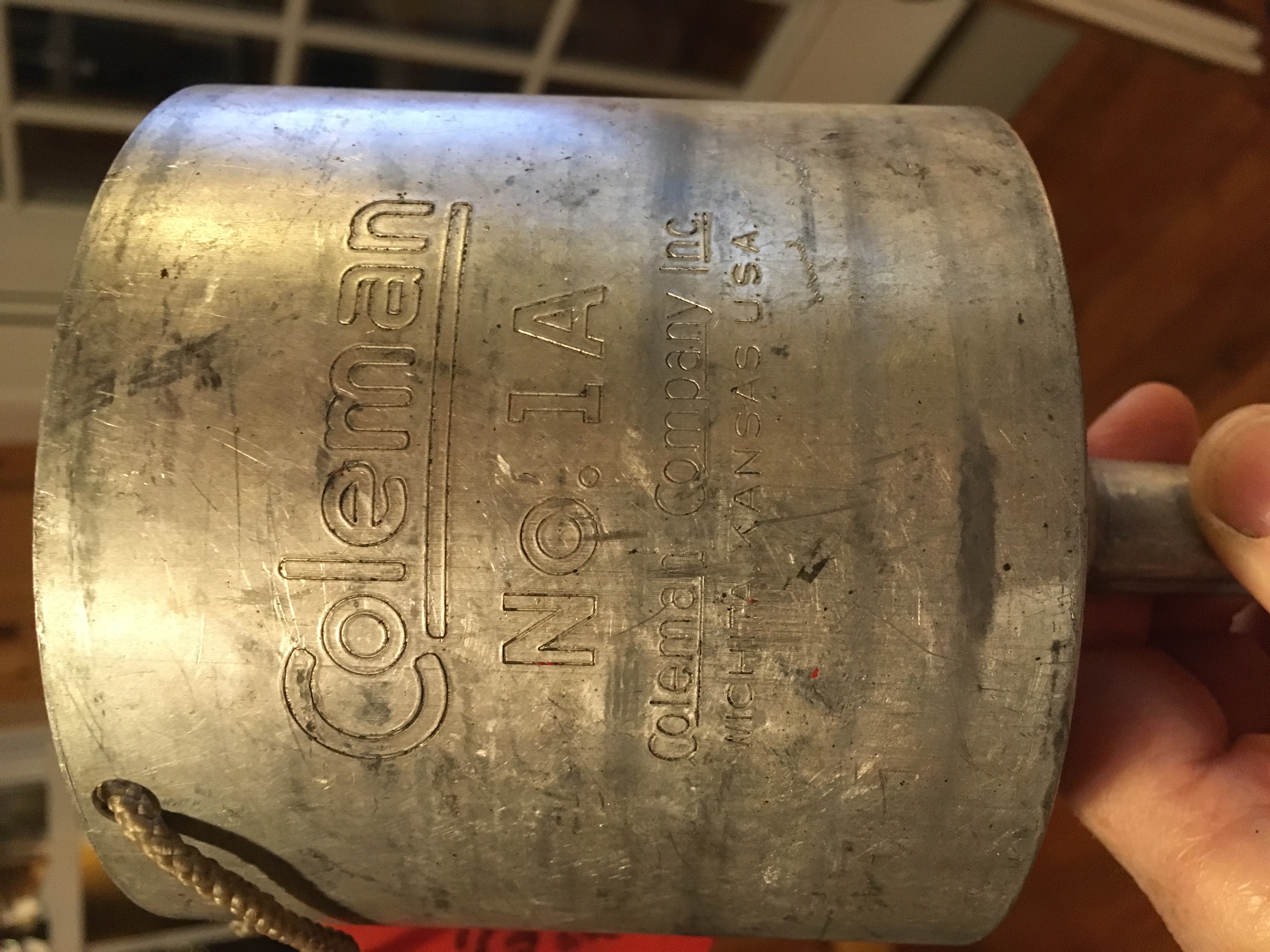

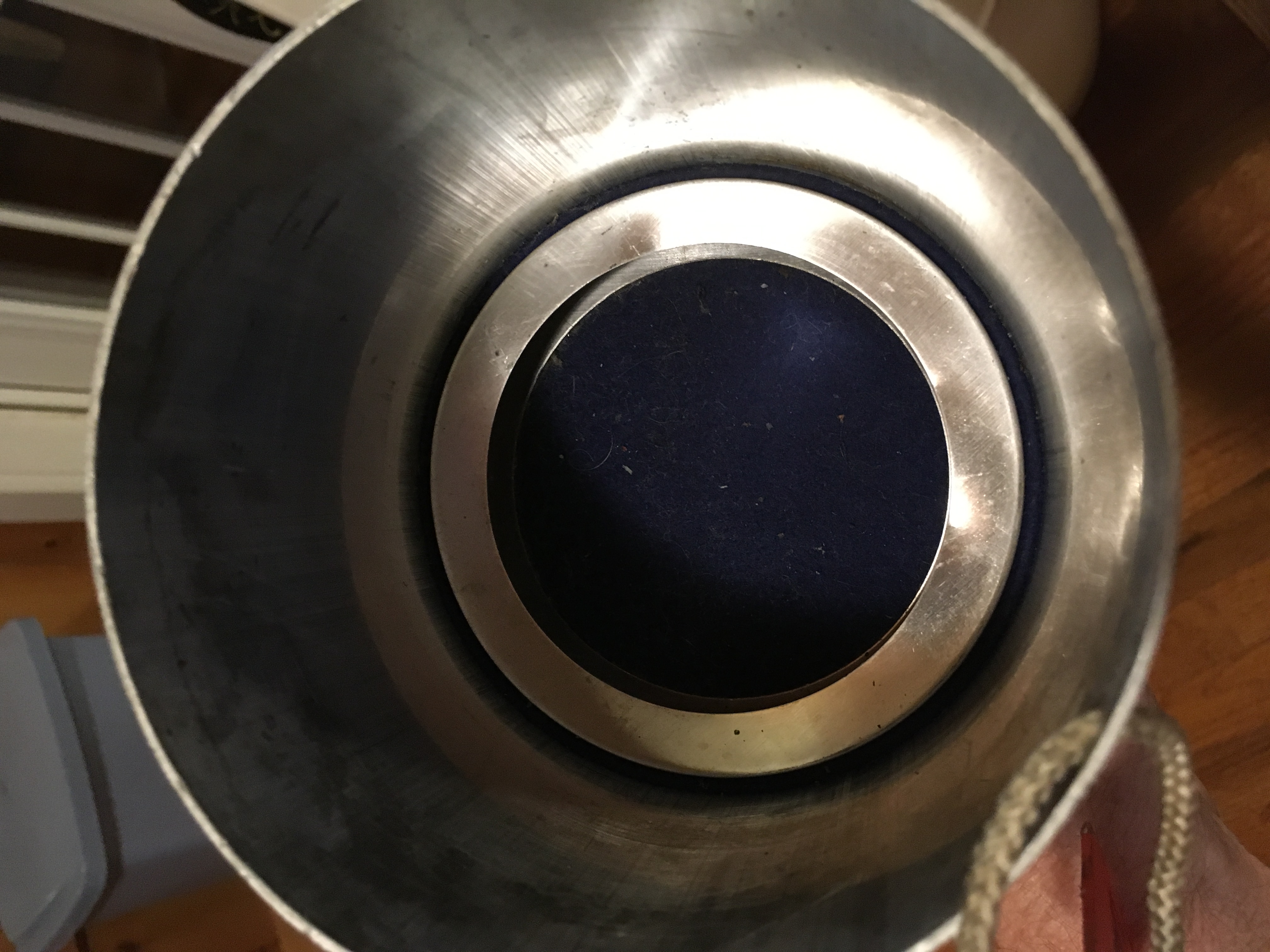

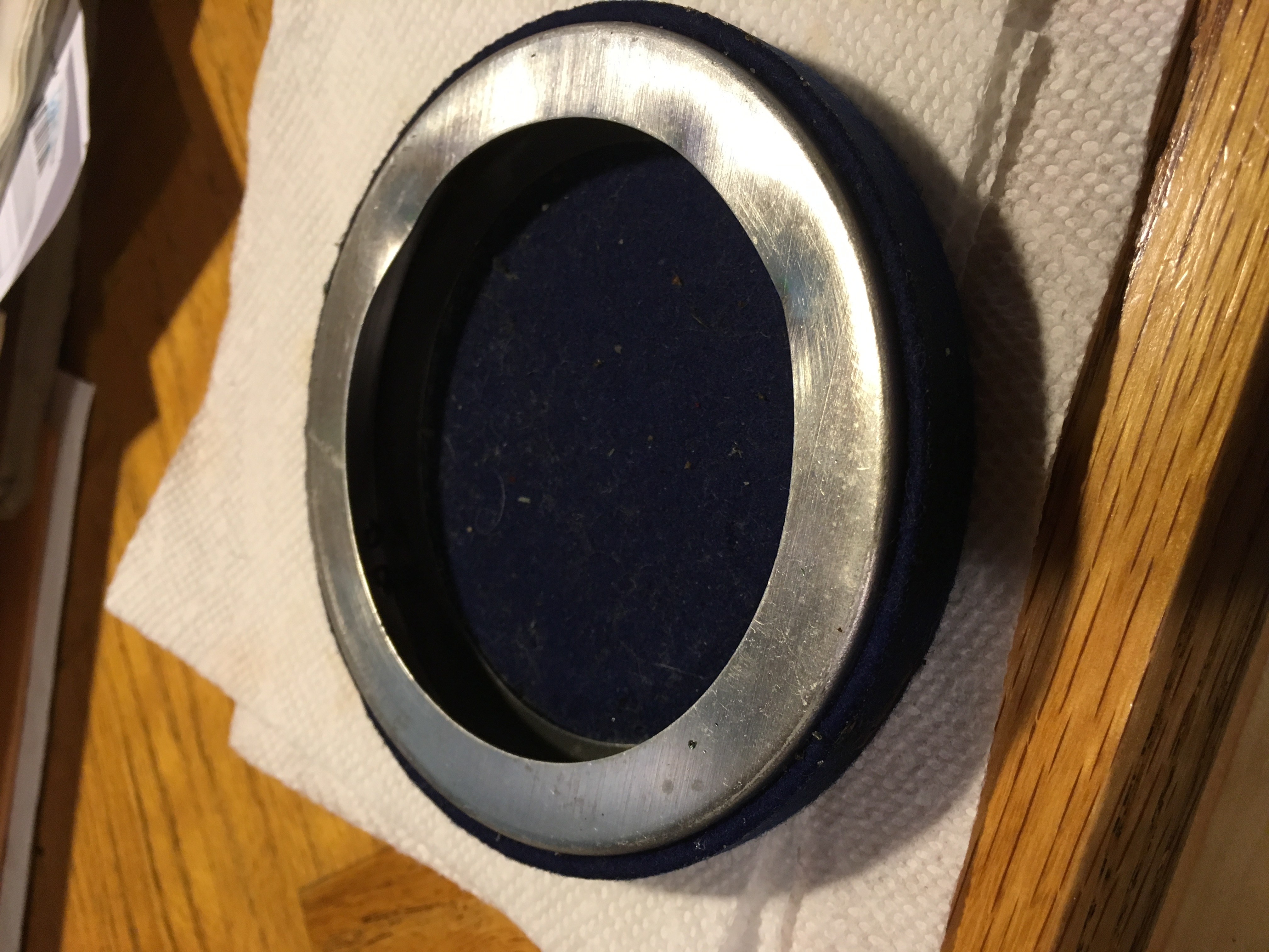

          I remember a friend having a gasoline funnel back around 1960 that had a piece of what looked like felt that the gas strained through. Any water drops in the gas were caught by the felt, and it worked very well. I’m thinking the water-separator devices do something similar.

            I use the same style funnel that outbdnut2 talks about. Every time I gas up a motor or a remote tank. Every time.
