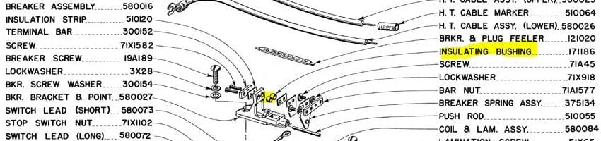

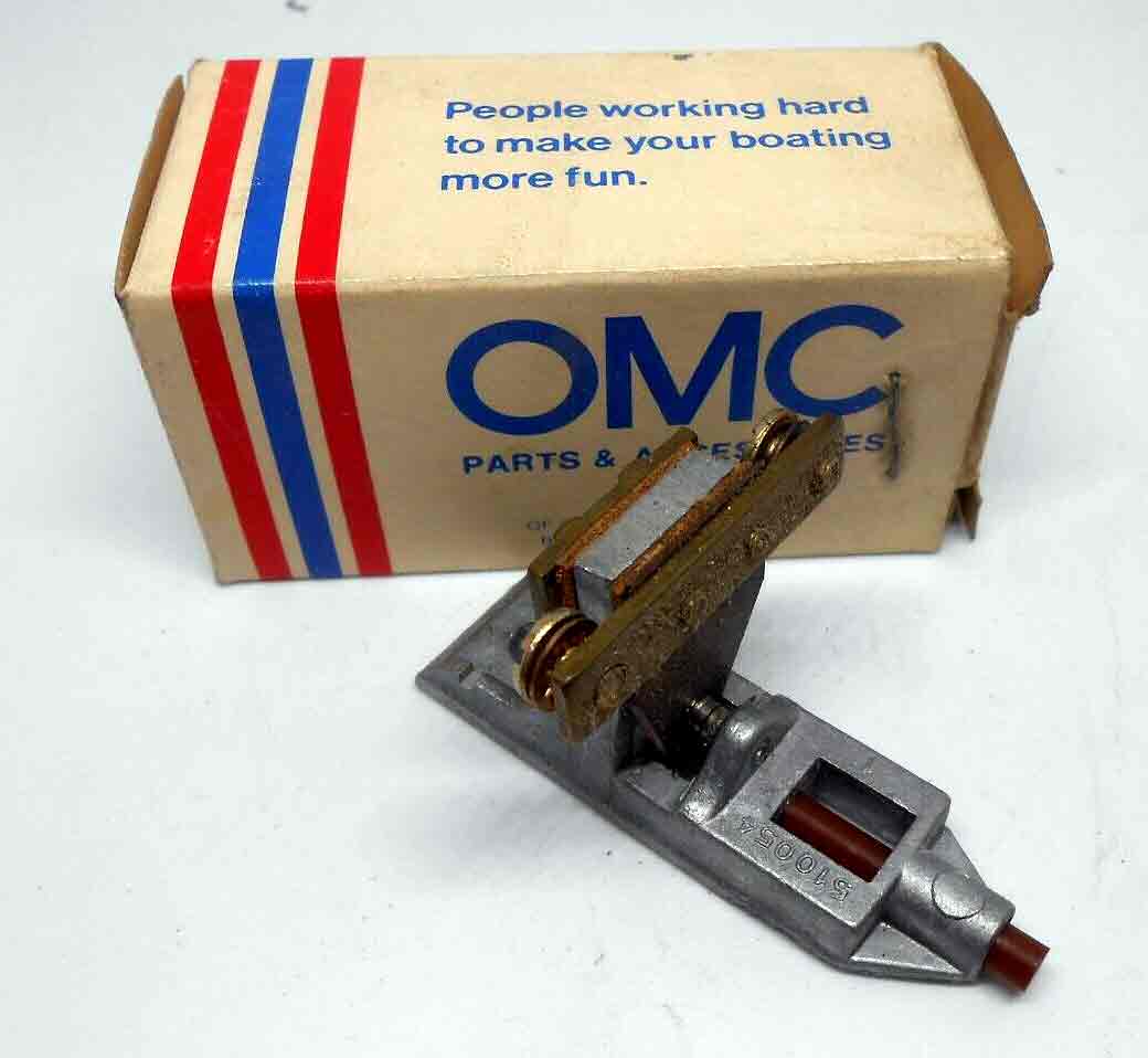

      What are people using to replace the insulation bushings used in the old style pushrod-style points…..the ones used in the QD-10 Johnson and various other older Evinrude/Johnson magnetos?
      Insulating-Bushing
      580016-Points

                I’ve made them on the lathe using Acetal (Delrin) and think I have the specs written down somewhere.
