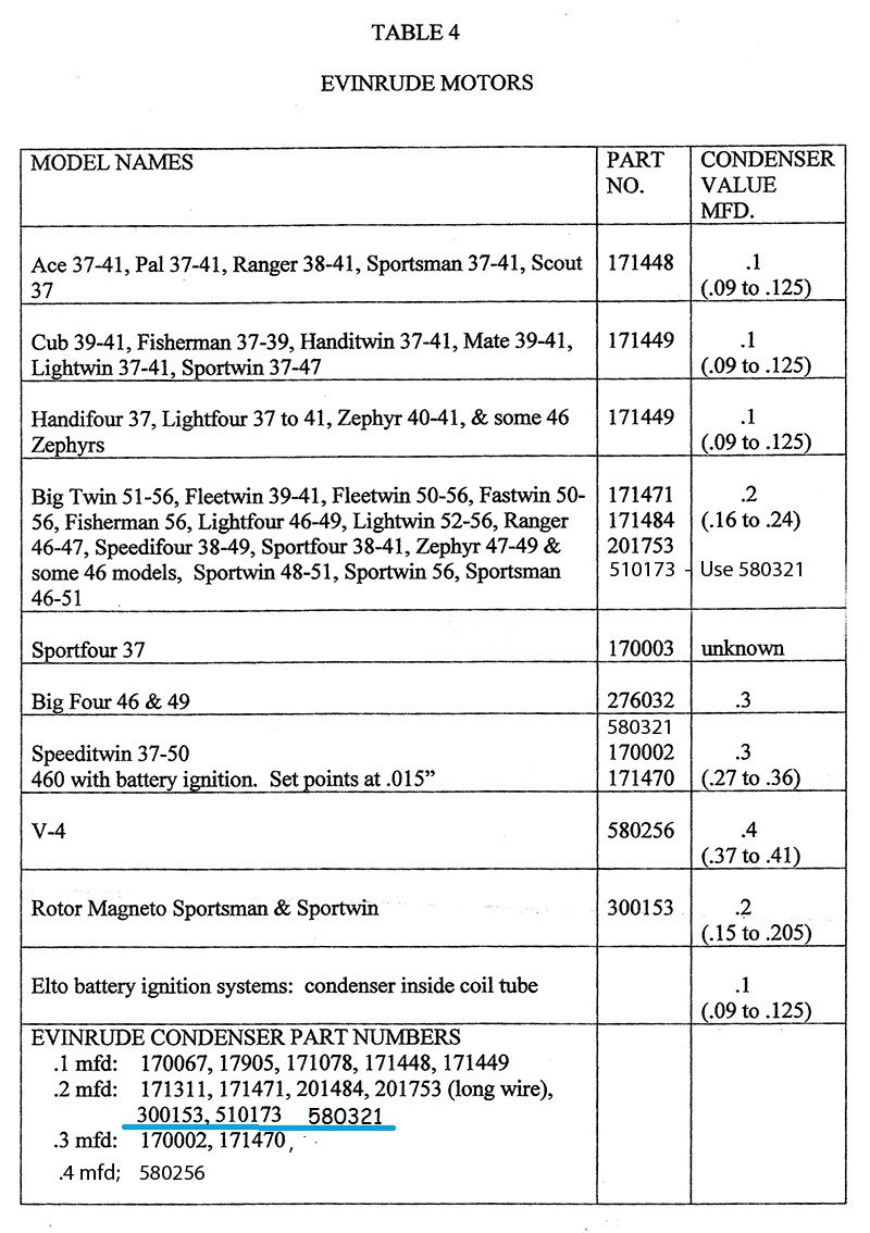

        At the time of that publishing (1953 ) Evinrude and Johnson were considered in competition and listed separately. I added the information I had to include the V-4 outboards. I still have not been able to find the capacitance of the Sportfour capacitor. At that time the Sportfour was long gone as it was more expensive to produce than the Speeditwin and put out less power. Table 1 was Johnson – 2 was Mercury – 3 was Marten & Oliver – 4 was Evinrude – 5 was a cross reference. . . .

                    Yo, Buccaneer, I deleted your Evinrude caps table as it showed the common 580321 capacitor  listed as  0.3 or 0.4 uF while in reality it is closer to 0.2 uF.  This was brought to Garry’s attention several years ago so here is the revised version.
                    If anyone else has the old Evinrude caps table in their files, you should delete it and replace it with this slightly revised version to avoid any confusion.

                      Does anyone know the condensor Value for a Evinrude Sportwin N.

                        Mumbles, just to clarify, Does the Speeditwin 37-50 need
                        the .3 cap, hence, the 580321 cap should not have been
                        listed for that motor?
