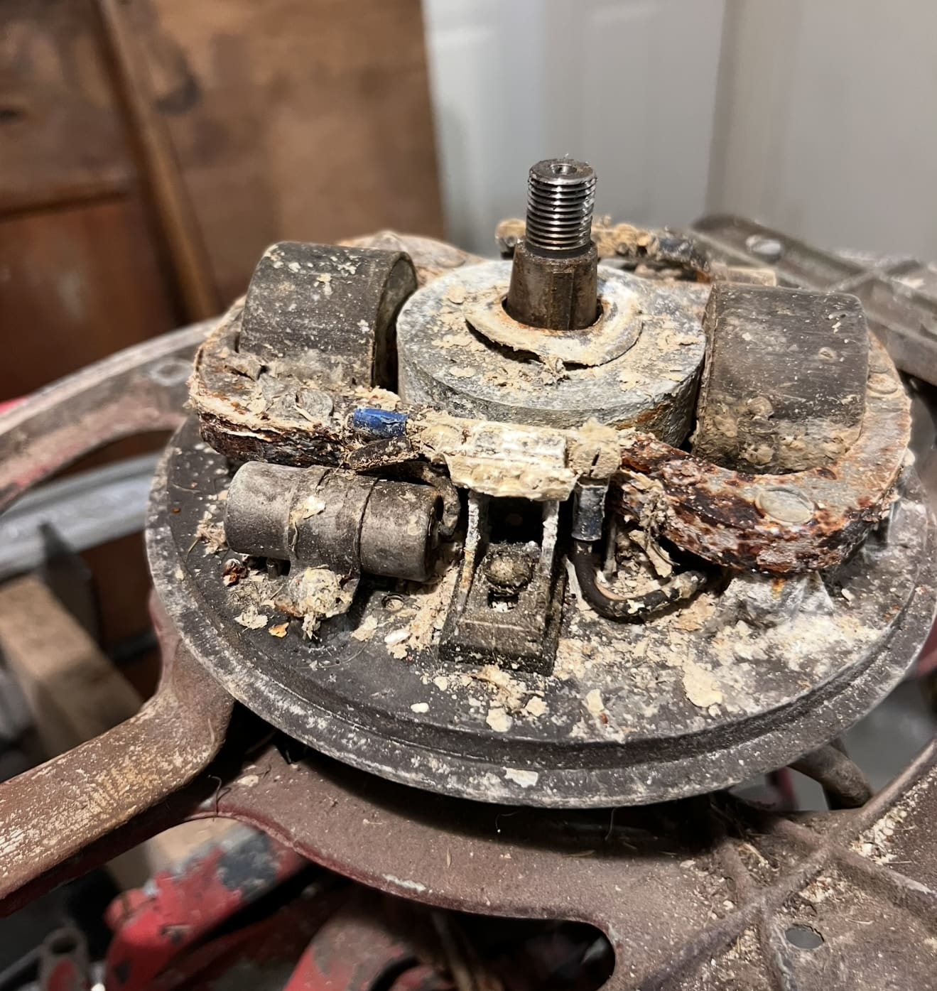

    I picked up the motor for $5 and the crankshaft/prop turns freely. The plugs look clean, but the magneto/stator is corroded.
    IMG_0482
    #293719
      yes, it is. coils may be good; point may even clean up. do a good cleaning and test parts condensers replace
