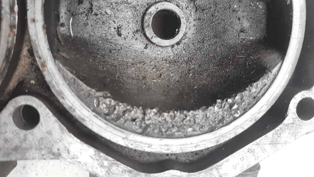

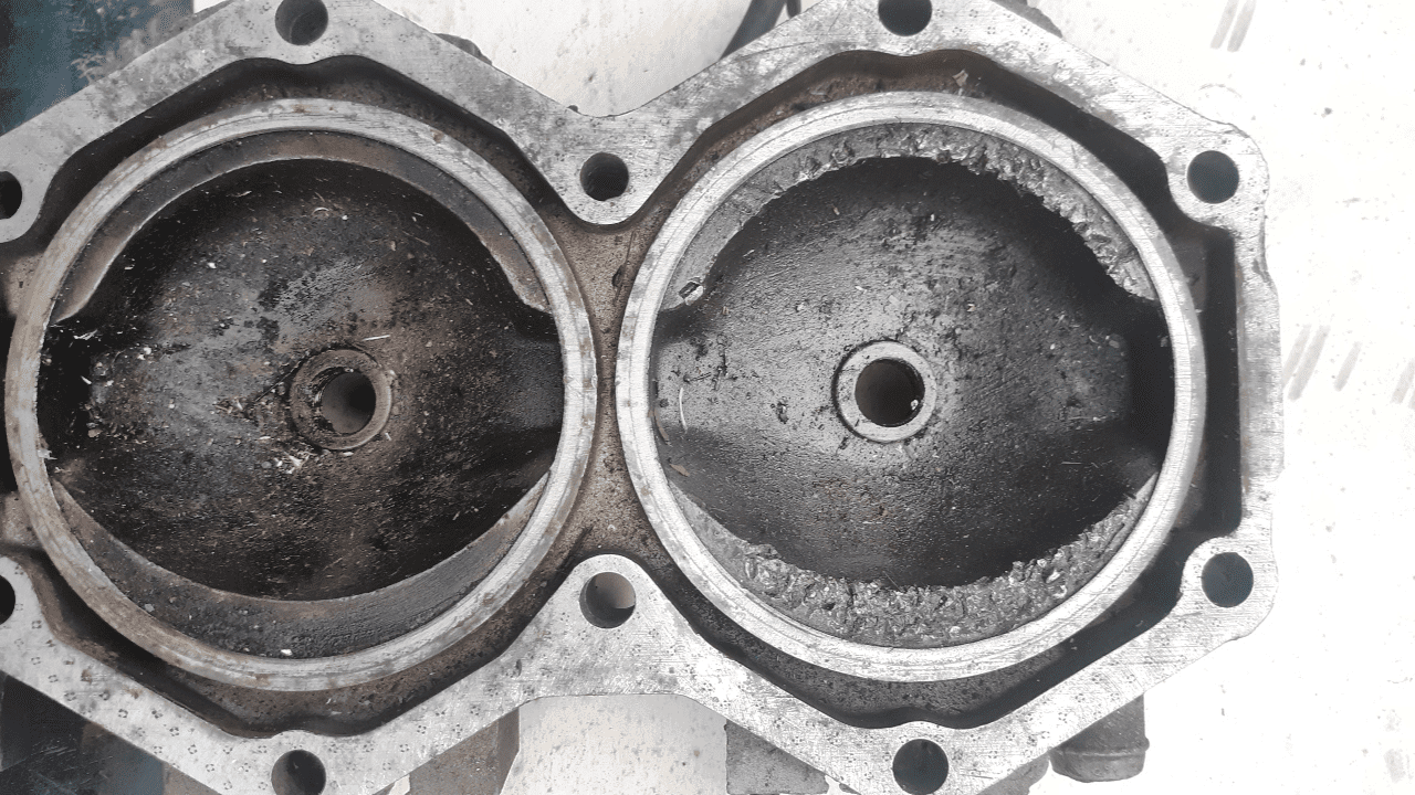

      I have this omc head… first shame.. i dont even know what size motor it came off of.. my guess is 88hp or 115hp omc v4???
      Secondly.. is.the damage too much to resell as a working unit ????
      See pics

        Well, I personally wouldn’t reuse it…All those little sharp dents/bumps could turn into hot spots and lead to detonation/preigntion… But, I’m sure it would be OK if you smoothed all the imperfections out with some sort of little sanding disk…Doesn’t have to be perfect, just get rid of the sharp edges….

              yes, it is off an 80s model OMC V4…I’m confused though, is this just something you have in your parts pile or are you working on the engine that this came off of? Most numbers stamped into castings are just that: casting numbers which are not actual part numbers and can not be interpreted by us mere mortals…

                  Well Beno, in this case, I would strip it down and add the aluminum to your scrap bin, not worth saving…D
                  #241983
                  DAN ANDERSON
