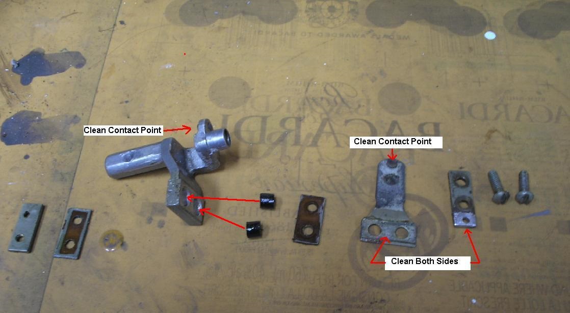

        That’s the way they come. Coil and condenser are
        soldered to the points. Not uncommon to loose
        spark in these because the points are corroded from
        sitting. You need to take the points apart and clean
        them. If your careful (coil wire) it can be done without
        unsoldering them. I don’t know of any later coil that
        can be substitute for these however it is the same coil
        found in the pre. WW-II Pal and Ranger. If you don’t
        unsolder the wires don’t be moving that coil wire
        around too much.
