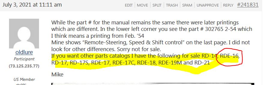

              Then….A member posted back in 2021 that he has a RDE-16 Parts Manual for sale:
              Offer

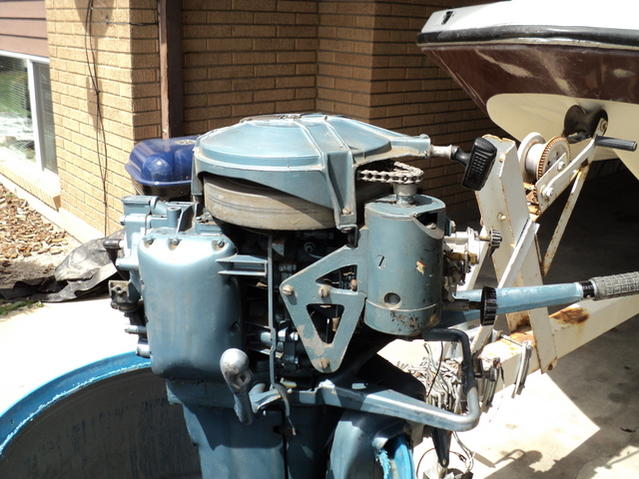

                        “The DynaStart” from Lausen  Specialty Company in Gainesville  Texas
                        25hp4
