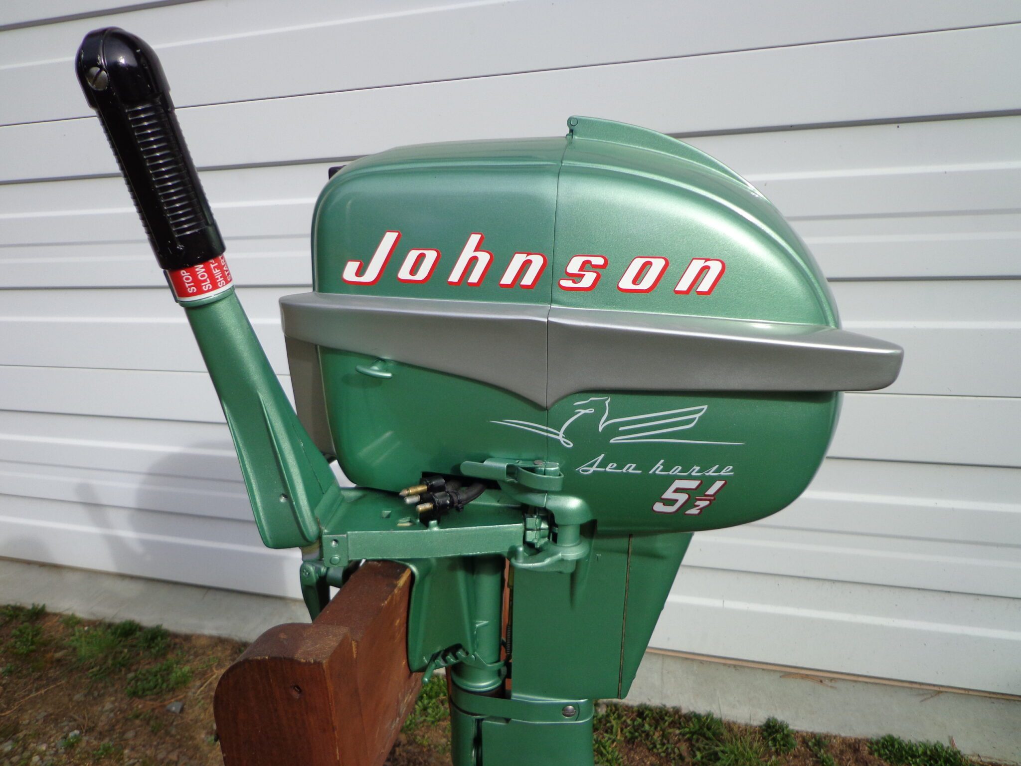

                      #250904
                      Gary Pasquale
                        Mumbles that looks awesome, hoping to get the same result, can you share how you did the two tone on the cover? Tips / Tricks? Also whre did you get the decals, I ordered some vinyl ones but I don’t think I am going to be happy with them.
