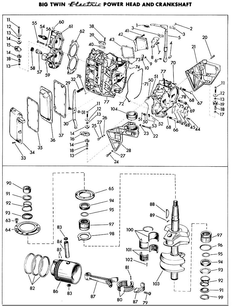

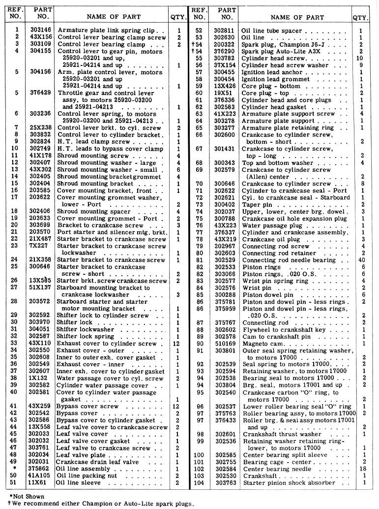

          If you want a parts list for RDEL-17 – RDE17
          private message me email address
          #229640
            I lost my -17S parts list in a computer crash. BUT I still have the Evinrude version. The difference in the -17 and -17S is the main bearings and seals. Evinrude showed the difference by serial numbers. Up to 17000 is equal to -17 and 17000-up is equal to -17S. Note the pictorial view shows the carbon seal type—-you have to go to the part number page to get the other type. Confused yet?

                I don’t know about your manual, but as I said they are the same motors except for the main bearings and seals. I might add that the design change that made the change to -17S was the 303804 lower crankshaft seal which was a horrible mistake, trashing many motors due to water ingestion.. OMC had to replace many powerheads under warranty. You really ought to remove the powerhead and see what you have. Who knows, it might be one of the warrantied powerheads with the carbon seal.
