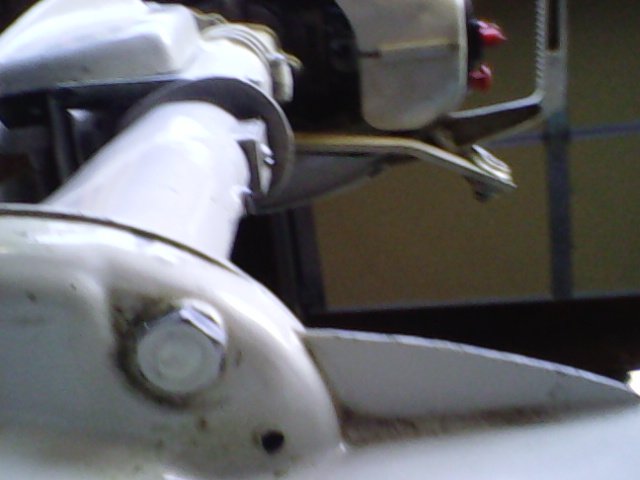

      I have a Seahorse that started fine before I worked on it! It had gas leaking out the lower end from this hole .
      I replaced some seals , and that fixed the leak . I also replaced the head gasket hoping to increase compression because the old one was pretty raggedy . Compression was 60 and 65 before replacing gasket. Now it is 45 and 55 and will not start !!. ,(GOOD SPARK!) OK , because of my ignorance about marine engines , I did not resurface the head nor did I have any idea for head torque sequence or correct foot pounds . I just used common sense and was careful . I just found the sequence and values here in this forum . I also repaired a rub thru spot on the plug wires where one had worn down to almost bare wire and installed some chafing gear. Also put a new impeller in the Water Pump. I have a new set of piston rings I want to install . So I’m guessing the loss of compression is probably due to not using sequence chart and possibly a warped head as well? I have stripped off gas tank , Needle valve/choke plate, intake pipe,and exhaust plate. I do not see scoring of rings or pistons thru exhaust ports, rings are so tight a fit that I can not really tell if they are frozen or not , (when I had head off I poured in Marvel Mystery Oil just in case ). OK so that’s where I am , What is your recommendation for my next move? Should I proceed with the ring job of first go back to the head and see if compression improves first ? As you can tell I’m a novice and any advice will be appreciated greatly . Thanks Jerry
