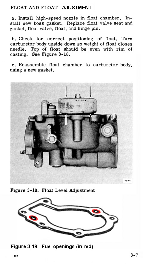

If you pump the primer, and fuel spills out from the air horn, the float is not floating, or the needle is not seating.
Perhaps the float is catching on the gasket?
Perhaps the float is upside down? Not to say you did that, but has happened on here before!
Dirt in the seat?
I test the carbs before installing. Once put together, hold it upright and blow into the fuel inlet. You should be able to.
Now flip carb upside down. You should not be able to blow into it now.
I do this after I clean, as I hate the taste of gas/oil mix π
May 9, 2015 at 5:51 pm #15595As a second thought, the float could be catching on the gasket, if the drop is set too low. See the tab on the float arm, the one that hits the casting for the needle/seat? That can be adjusted, to give you proper float drop.
If that tab is sticking up in mid air, the float is upside down.
EDIT: Is the float original? If so did you coat it? Test it in a bucket to ensure it actually floats?

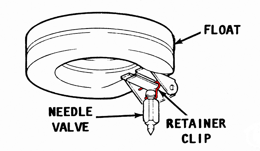

May 9, 2015 at 6:53 pm #15600To my great embarrassment, I had installed the spring clip on the float needle upside down. It was the only thing I didn’t think to change in all of the on-and-off, apart-together with the carb. The motor runs like a top from the first pull. I don’t think it will even require much carb dialing-in. Not the first time I have made myself look stupid and I know that it won’t be the last. I hope that someone else can resolve the same issue quickly for themselves now that I have documented my stupidity. π³

May 12, 2015 at 2:13 am #15760Don’t beat yourself up – You are not the first, and definitely not the last to be confused as to which way that clip went.
