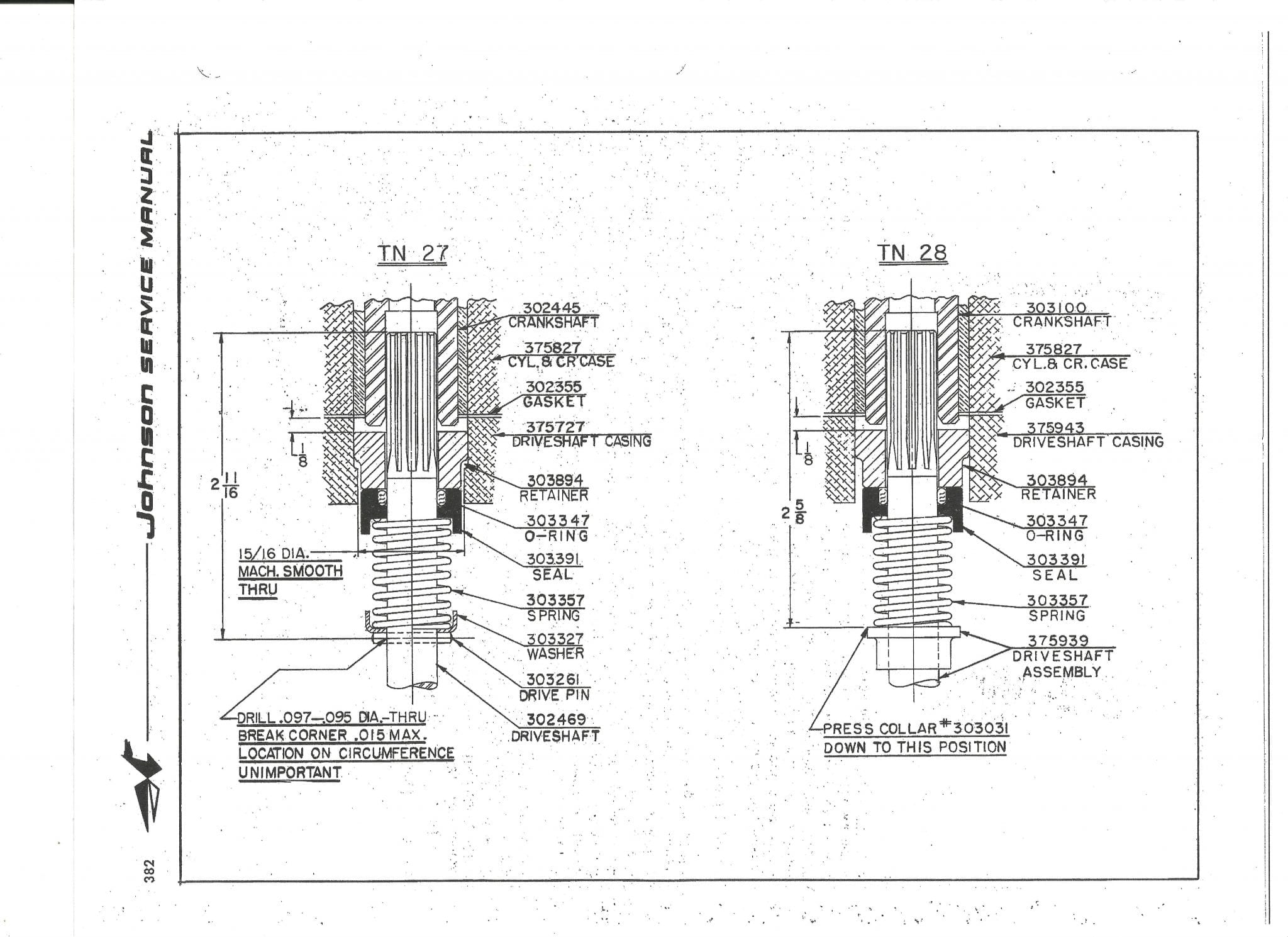

      Trying to build one usable dependable motor out of 2 TN’s that I have. One is a 27 and the other is a 28 What are the differences between the 2? What parts might not be interchangeable ? Thanks Gene in Mn
      #218031
        The most obvious difference are the tank decals and the lower crankshaft seals had a slightly different design between the two. That’s all I’m aware of.
