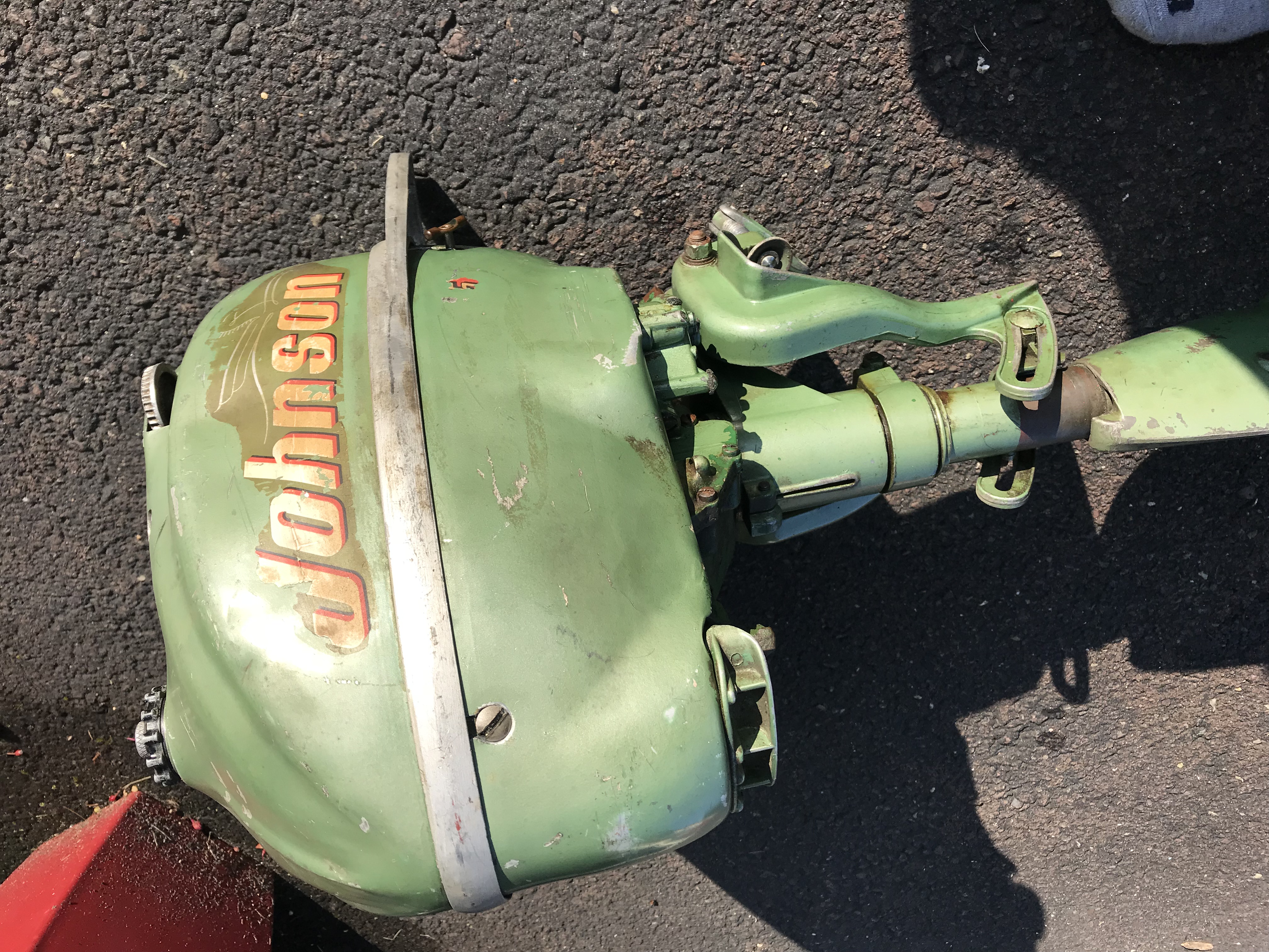

      I am wondering if there is a way to tell if this motor is pumpin water? I don’t know where to look and don’t see water coming out anywhere. Really I have no idea how to check and wear to look on this motor

        Alex,
        There is a “tell-tale on the power head which will indicate water circulating. It is hard to see as it is just a small drilled hole in a brass fitting.
        Ben Ditmar has a YouTube video of one you can see.

          Here is Ben D. (Chrysler outboard dude) YouTube video.
          https://www.youtube.com/watch?v=35kv1atTIRw
          The tell tail water stream is shown at the 45sec mark.
