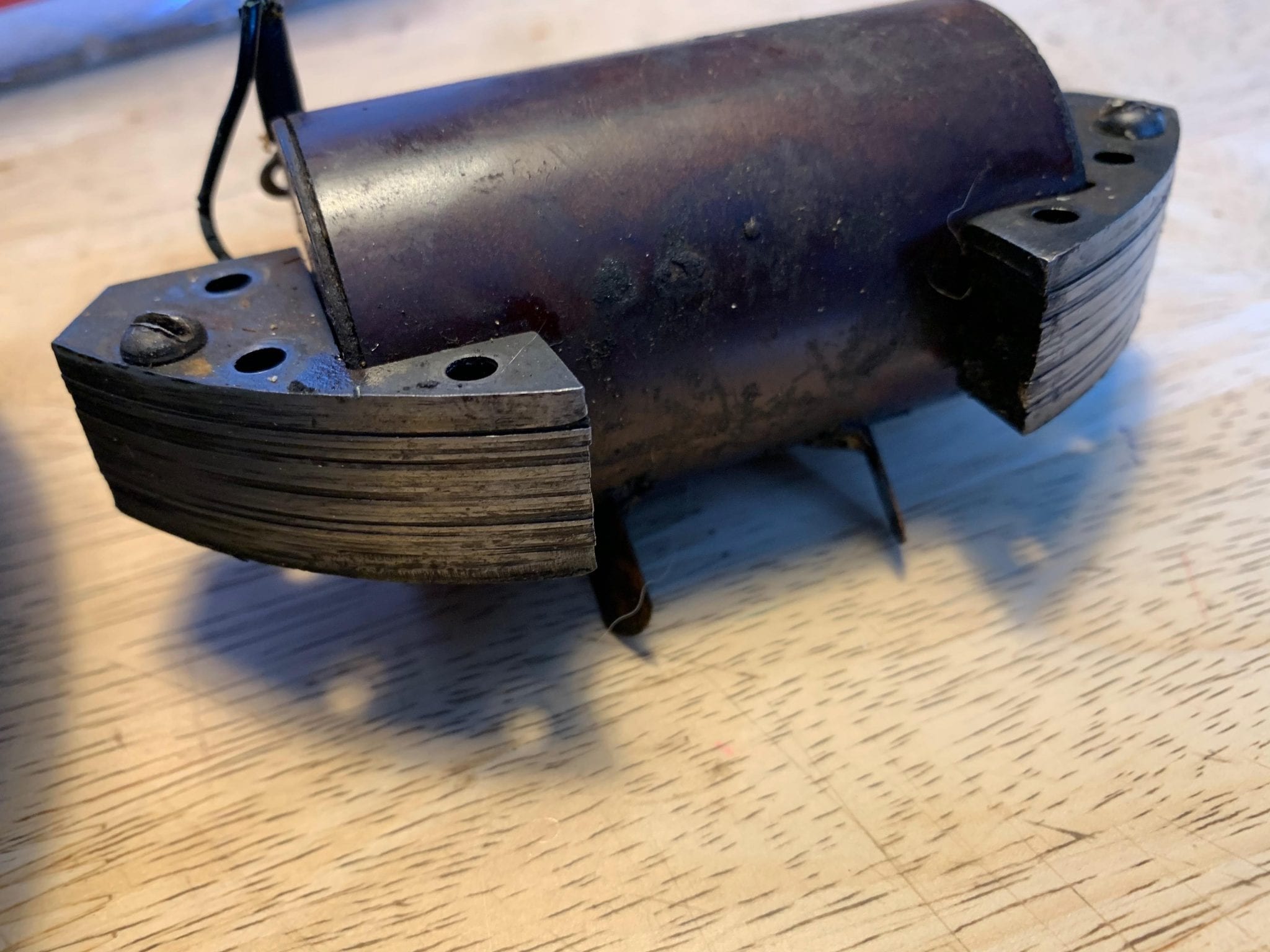

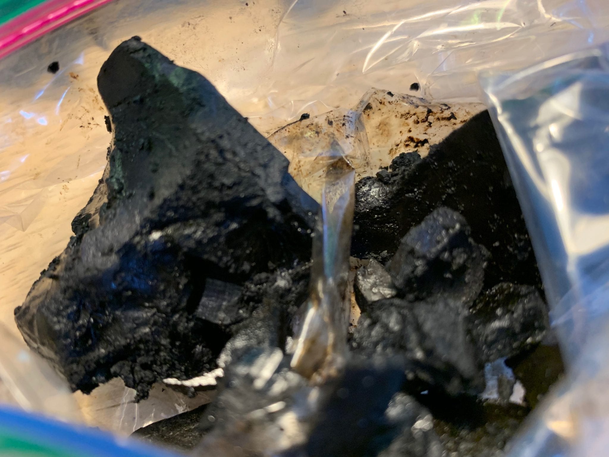

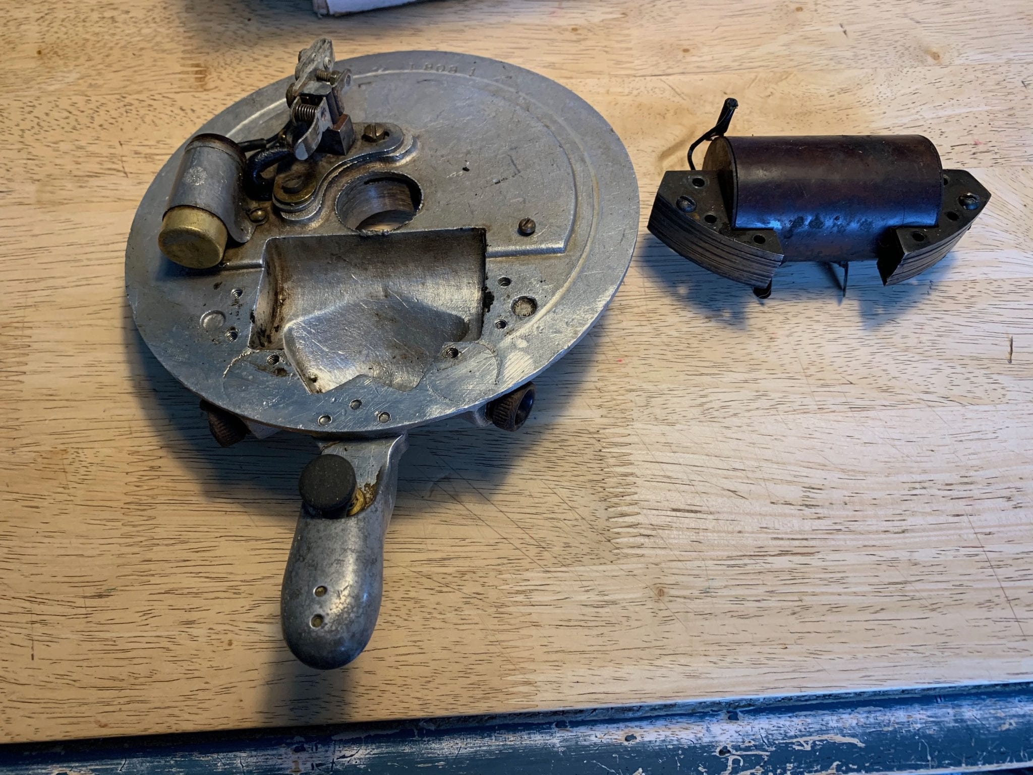

      I found clumps of pitch, or tar, under the coil of my A 35. I want to replace the wires. The current wires were pressing up against the brass(?) tabs on the coil, but not soldered or connected beyond that. Is it best to do the same thing with new wires? Strip and press them up agains the tabs and pour in more….stuff? Where would I get more pitch?

      davidk
        IMG_2448
        IMG_2449
        IMG_2450

          #195403
          nabmd
            I believe the blacky tarry stuff was used to insulate the coil from the mag plate. I too cleaned it all off, only to be told later why it was there. I put down ‘Liquid insulation’ over the whole cavity area and my A-25 is working well. NABMD

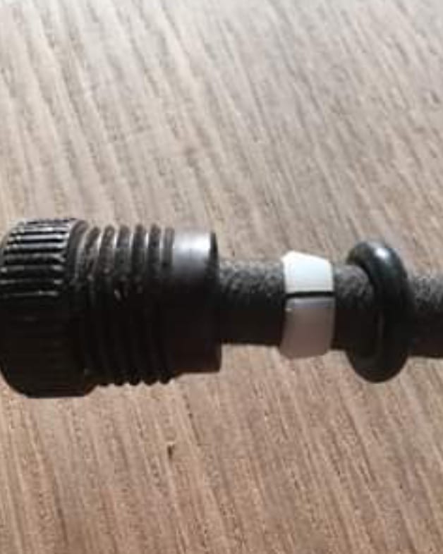

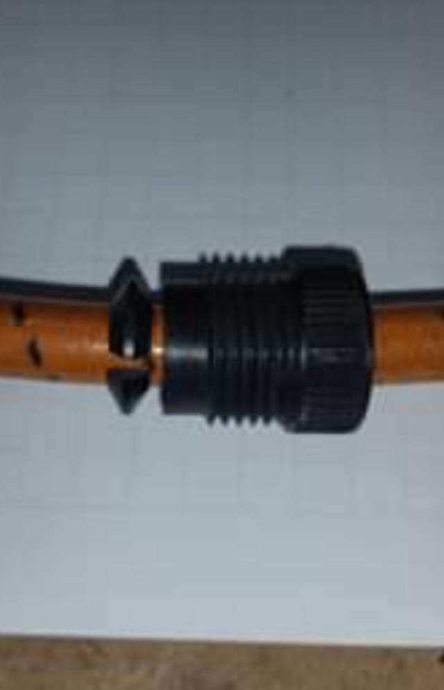

            #195421
            GARY
              I am assuming you are replacing the plug wires also.Use 9mm wire and something like the pics show to hold them in place.You can then put some liquid tape on the connection.No real need to melt that pitch and re-use it,but if you do realize it puts off some dangerous vapors.
              78D578D1-C013-43FA-8062-B4C8C0EA607B
              91EB4535-3862-4DE3-8054-2A724D8535AC

                #195450
                  #195451
                  davidk
                    I haven’t seen that glass tube/spring setup before. Interesting solution Tubs. How do you insulate your tack connection?
