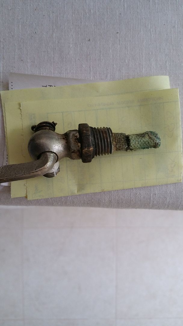

      The fuel screen for my Johnson A-45 is a little beat up:
      I’m having trouble finding a source for it, but I could probably make one if I could find the appropriate sized brass mesh. Any sources for this?

        I made one out of a old coffee filter ( gold color screen type) . You can also find the 100 mesh screen on Ebay in small quantities.

          Here is a source http://www.enginads.com/pedersen/
          I have bought a nice plug wire from him but not this screen.It’s listed under gas tanks.

            A lot of members here make their own.
            Get a piece of wire mesh and cut a piece to fit.
            Then wrap it around a small cylindrical object to form the roundness.
            Once your screen is formed to fit to your petcock, solder the seams.

              I get the plastic in line fuel filters made for lawn mowers and cut them open to get the screen out.

                  I have some 100mesh brass screen you can have if you give me your mailing address. Send me a PM.
