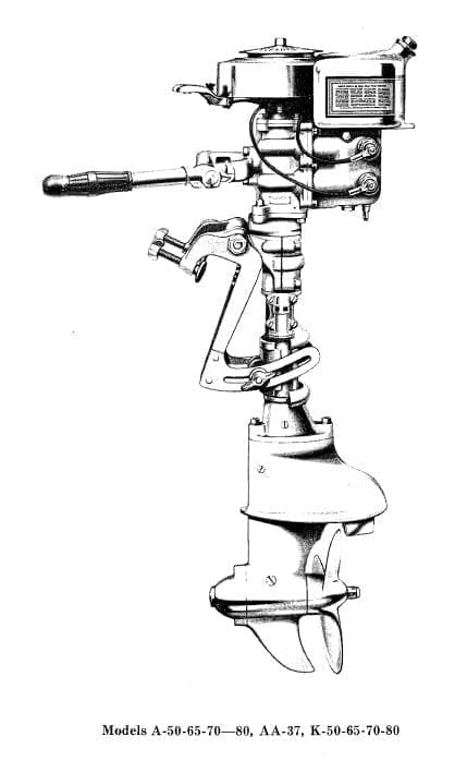

        Going by this illustration, I’d say they are basically the same externally but that’s where the similarity seems to end. A-50 is 4 HP while the K-50 is rated at 8. The K-50 also has larger bore and stroke plus a larger gas tank.
        I dio have a parts book and I should check and see what parts they share.
        A-50-K-50
        A50K50

          Bore and stroke differences were my thought too. I also would have expected the carburetor throat to be larger on the K-50.
          Thanks for confirming that I wasn’t overlooking something obvious. We are dealing with merely 90 year old outboards here, who knows what parts have been repclaced over the years to keep them running (I was thinking that may be the case with the K flywheel on the A motor).

            Visually the A powerhead should look smaller, maybe you have a K rope shieve on an A motor? If you have the two next to each other, as mumbles stated, the tank is smaller, it should be noticeable. Also, pick them up. Then you’ll notice a difference.
            I will say it’s hard to tell when you see one in a picture without a caption though
