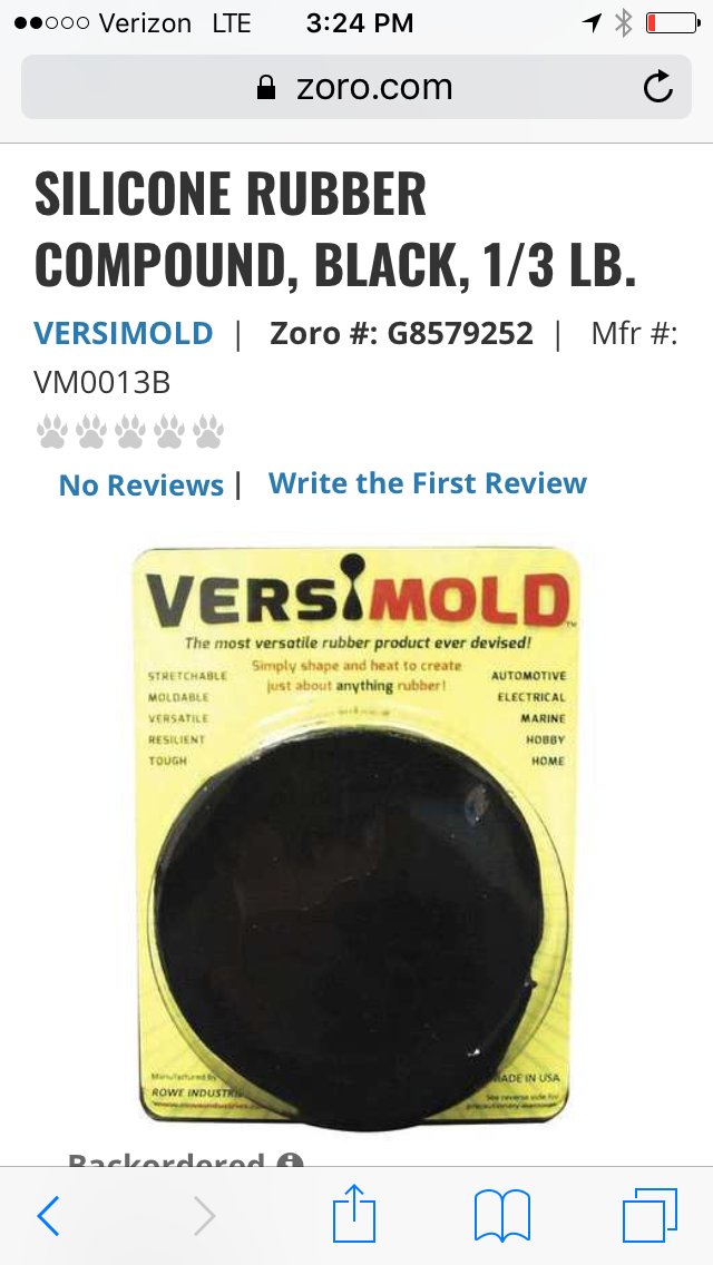

                  GARY
                    I’ve used this.
                    #83330
                    cajuncook1
                      quote Stanley:
                      I’ve used this.
                      Nice recommendation, I like it!

                      #83333
                        Sounds pretty handy. Lots of videos on YouTube……. here’s one…..
                        https://youtu.be/x2OXOVdQXd8
                        Not as cheap as silly putty, but may be more fun.
