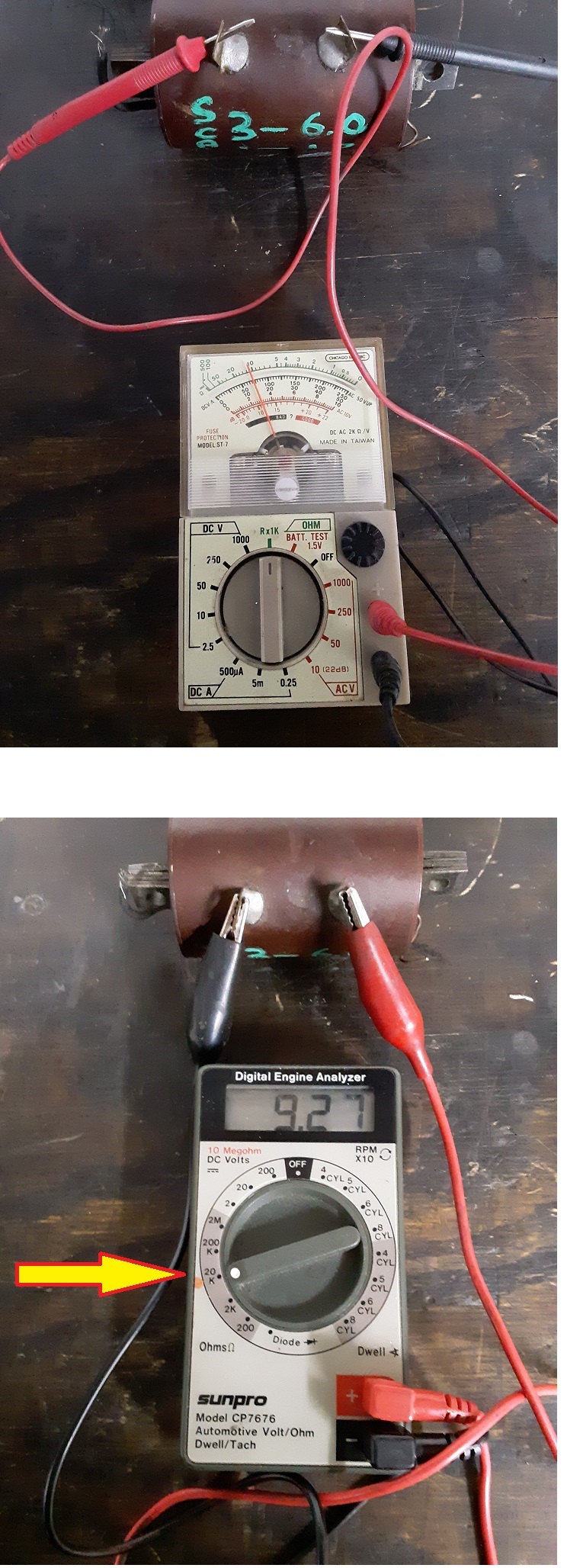

          You can tell by my testing devices, I’m the last guy that should be giving advice on electronics.  But I have learned – to check the secondary, on a 2 spark coil, you test between the 2 spark plug leads. If you’re using a digital meter, it needs to be set on 20 K ohm scale.
          coil-test-XYZ
          #301739
          Waunnaboat
            US Junior Member
            I did that but got no reading at all, so I am looking to replace it.
