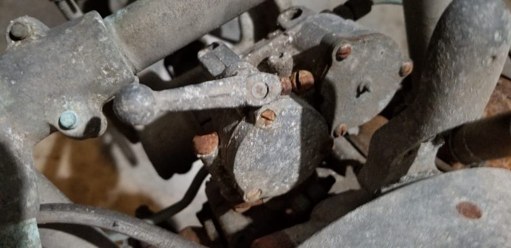

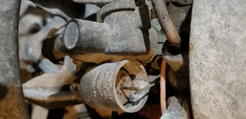

            Richard and Stanley , thanks for the replies. I realize now that I messed up on the post. I have recently gotten two engines. I was looking at one engine and thinking the other. One is the AB-25 with the brass lower unit. That is the one which has a bad carburetor. It has a carb, but I don’t know enough about how they are supposed to look to know if it is complete. I also have an engine A21092. No dashes in the model number. I am attaching pictures of the carbs on both engines. The second picture is off the A21092. That carb looks complete. It has a what looks to be a wood kill switch. The other picture is the AB-25. Note that it looks like the top of the carb is gone, but unlike the A21092 it has no screw holes to attach a top, but the plate inside seems to slide on the rod and there is what looks to be a retaining spring that touches the rod. Note the A-25 has a bakelite or fiber kill switch instead of wood. The carburetors on the two engines are completely different.

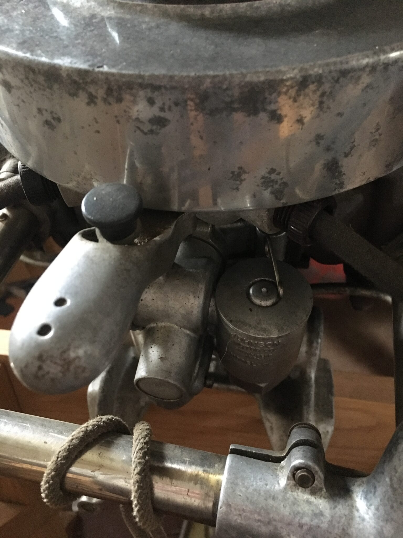

              Here’s a picture of carb top and kill button on A25.Your#21092 should have same carb and button if it’s a Johnson.From what I can see it’s carb looks like from a different make of motor.Do you have a picture of the whole engine?

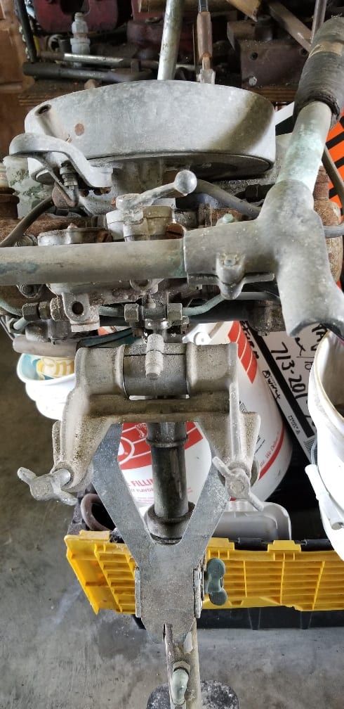

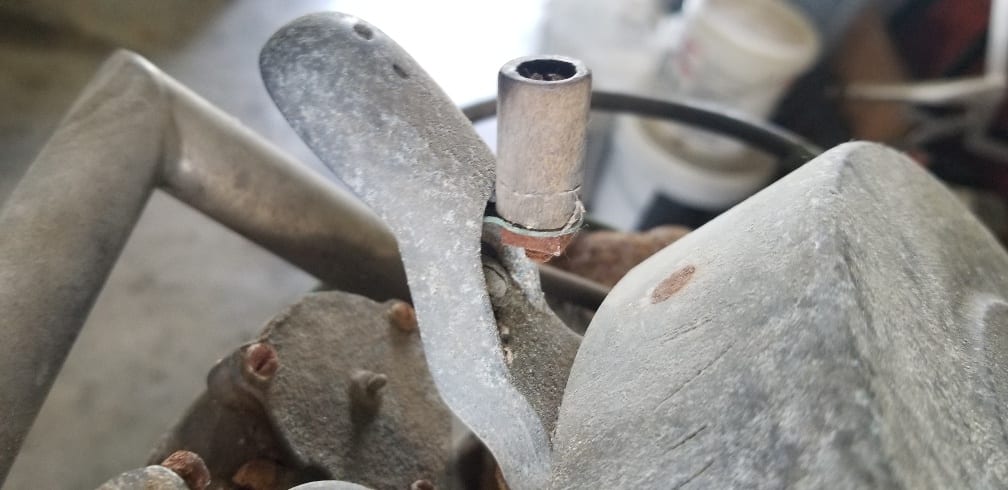

                Stanley I think it is the same carb on the AB-25. Apparently there is a cap on the bowl held down by the spring wire shown on yours. The bowl Cap on mine is gone. Other than that it looks like your picture. The A21092 side view picture attached is good, but the other two aren’t as good. One is a front view and the other shows the kill button. It is definitely a Johnson according to the flywheel. I read somewhere that the later A s did not have the raise lip on the top of the flywheel? Is that correct?

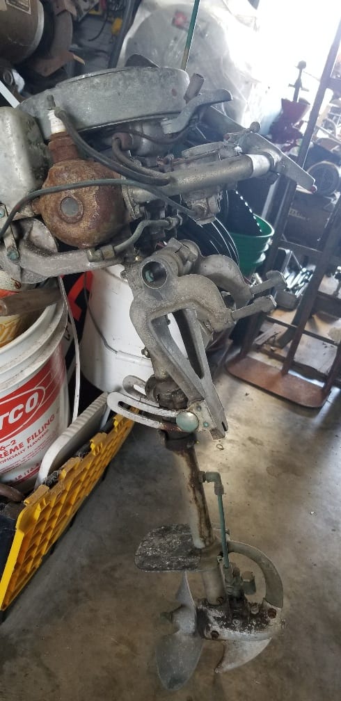

                  Side view

                    Your new pictures show a Johnson light twin that has had some foreign parts grafted on.The carb looks likes it’s from an Evinrude of some type,and stop button is home made replacement.The early “A” model fly wheel has a concentric raised portion in the middle that extends beyond the rope plate.
