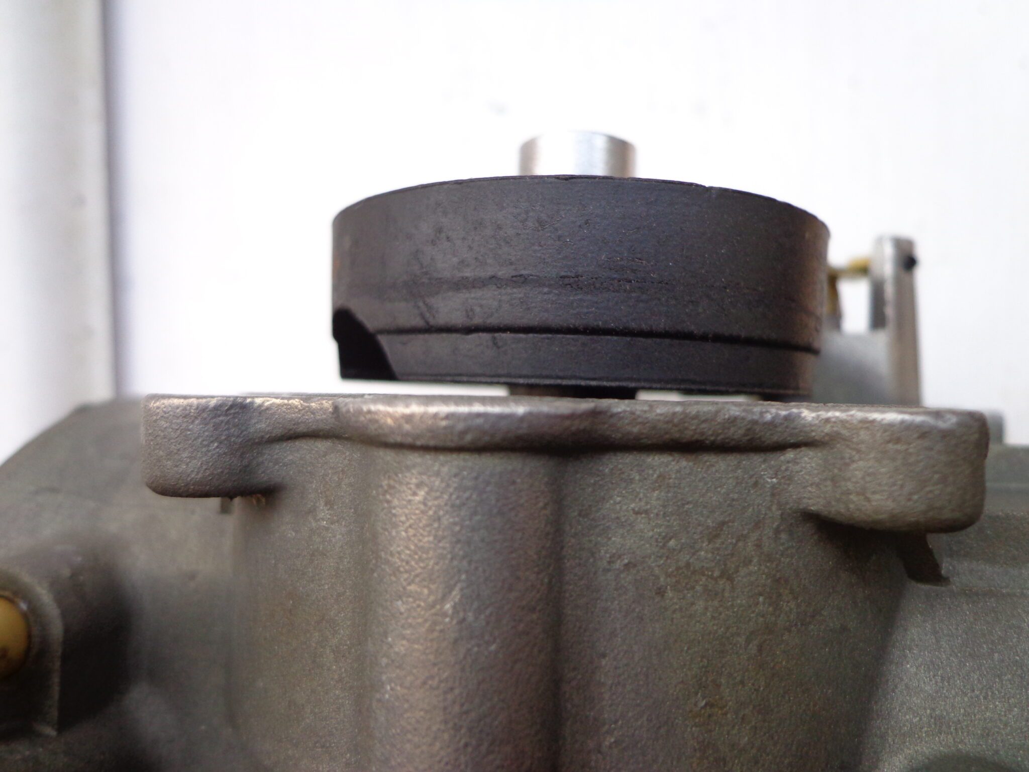

            Was the fuel pouring out of the carbs throat or just pooled up in there?
            DSC00036
            #259817
            russ
              No it was leaking out the throat and down the front of the carb.Will pull it apart again and recheck.Thanks Mumbles…..
