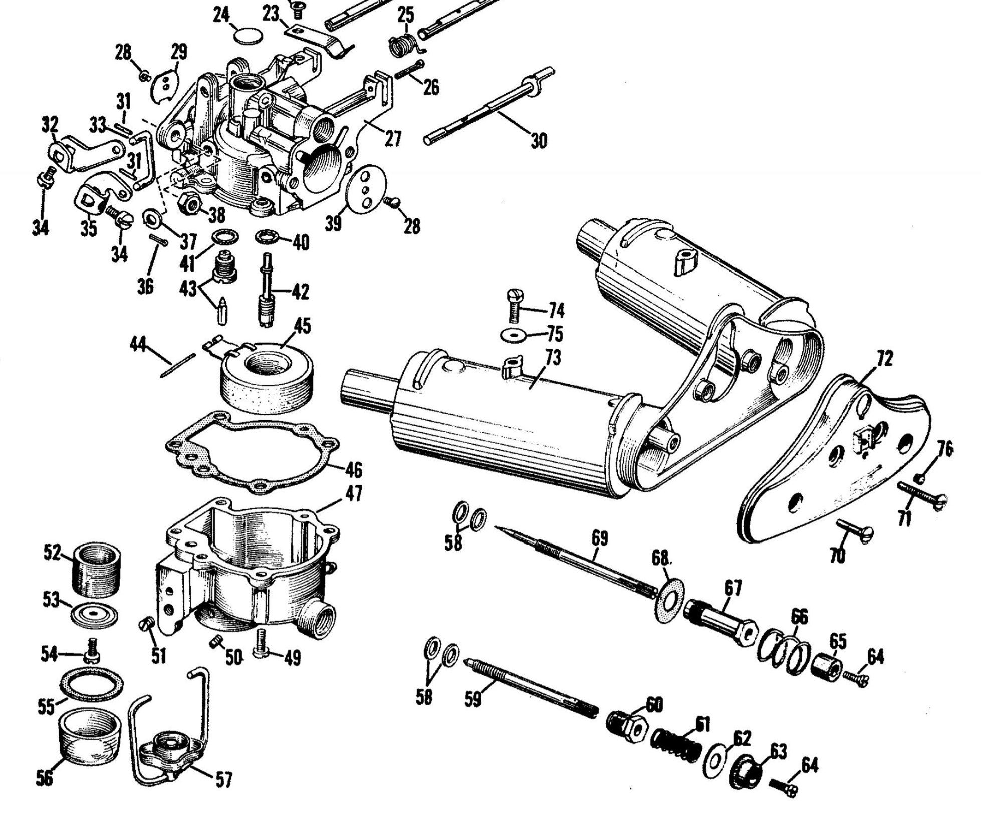

      Have 1 final small issue with my 1st painted motor a Johnson CD12.  The front plate where the choke, speed, etc. is loose and doesnt stay in place when screwing back in the knobs ?  When I put the hood back on. it is about 1/4 to 1/2 inch back from the hood.  Is there a trick to keeping it closer to the opening in the hood ?  Thank you for any help.

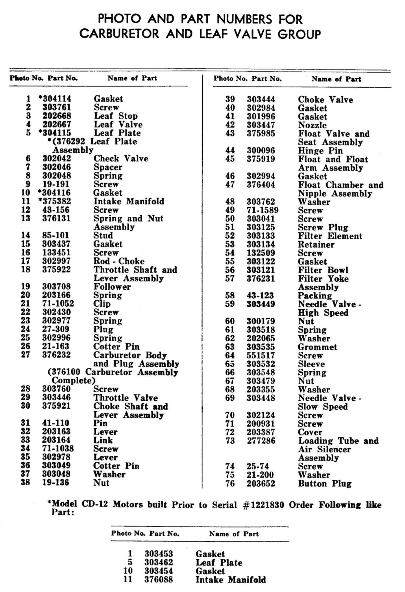

        Do you have the springs 61 and 66 and the other associated parts in place behind the plate?

          Thank you Steve,  no ,  I do not have.  Must have been removed some time ago.  Looks like I am headed to the hardware store.    Thank you, much appreciated

                Ok Rick, I got ’em…pretty sure these are the ones, or close. You might have to stretch one or both springs slightly. If you don’t want to list your address here you can email it to me.
                Edit: I’m missing the washer #62, I’ll go look for one, or you can just use a suitable size you have on hand.
