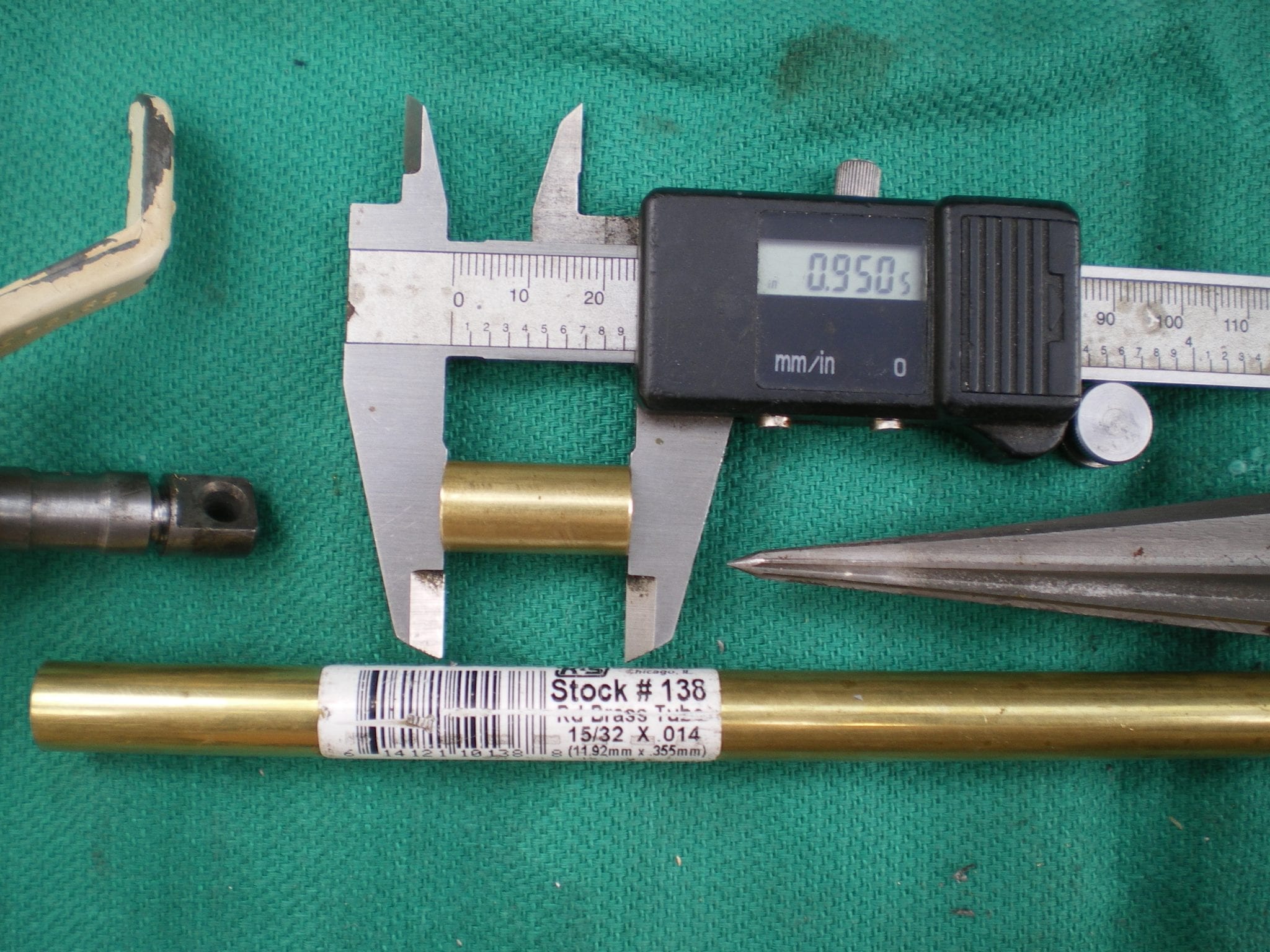

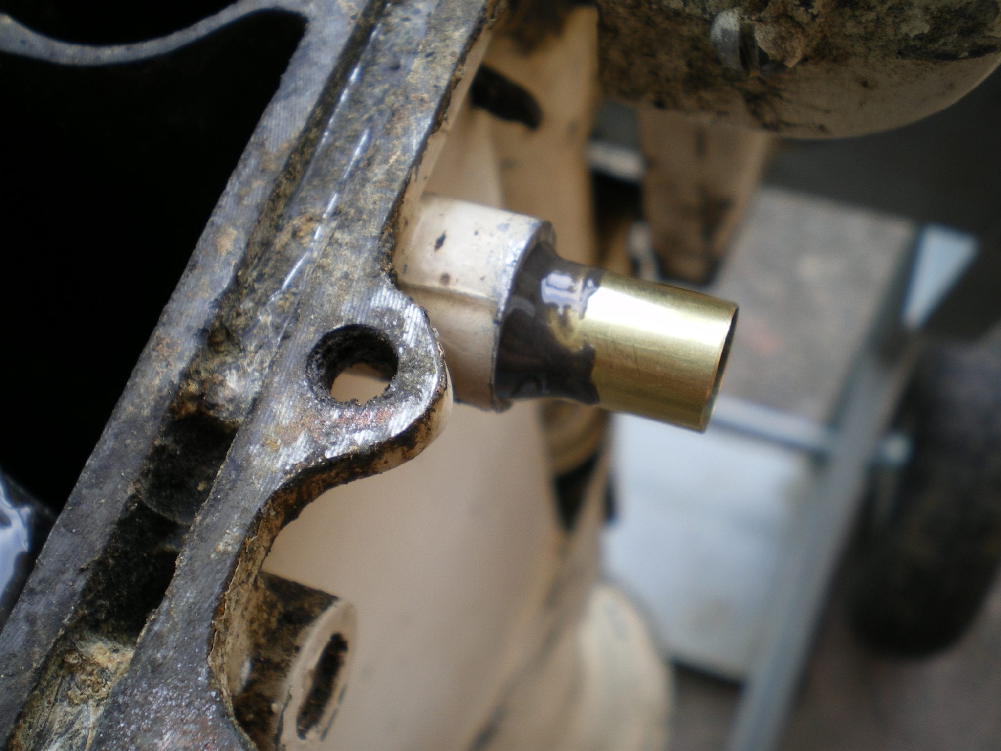

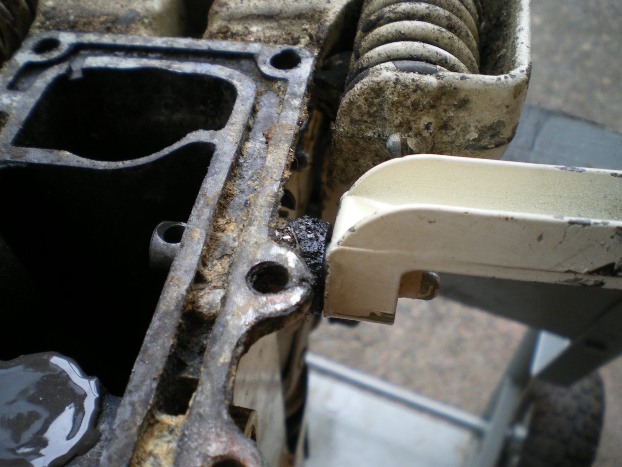

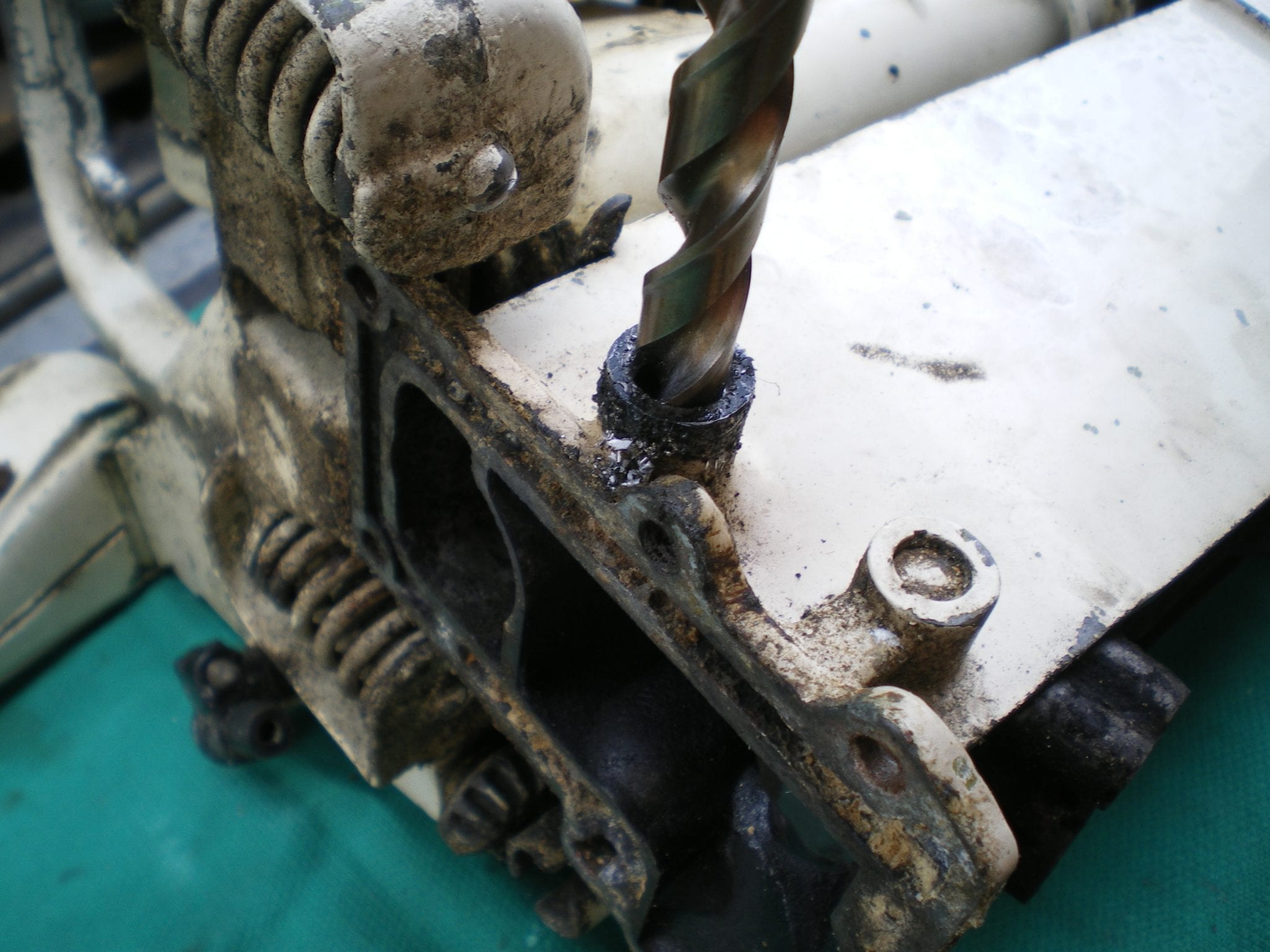

              The drip and the slop can both be easily fixed by drilling out the housing to accept a bushing made out of brass tubing. The tubing is available at a hobby shop and just about every motor I tear down gets this treatment for ‘like new again’ performance.
              IMGP1908
              IMGP1907
              IMGP1909
              IMGP1905
