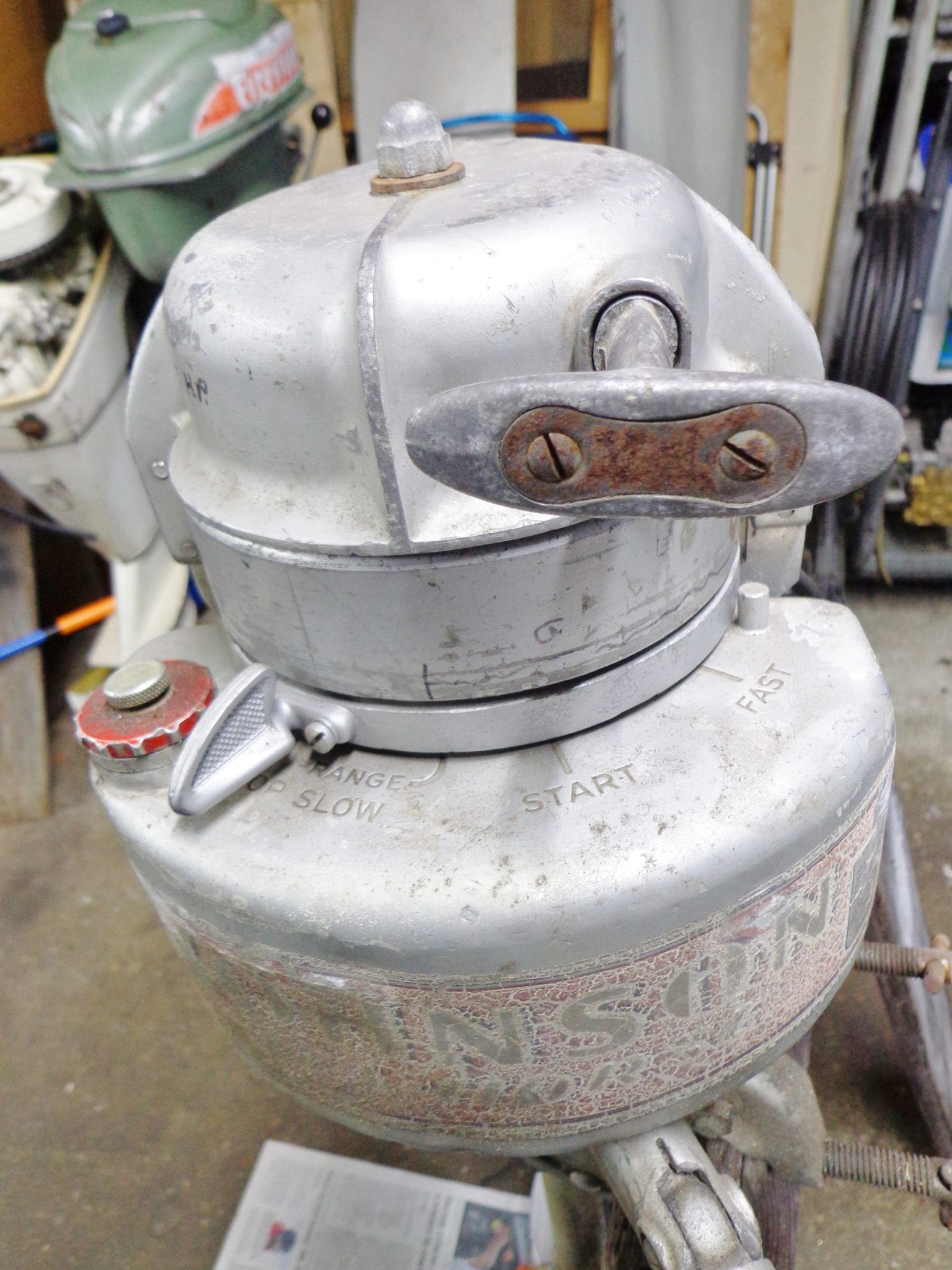

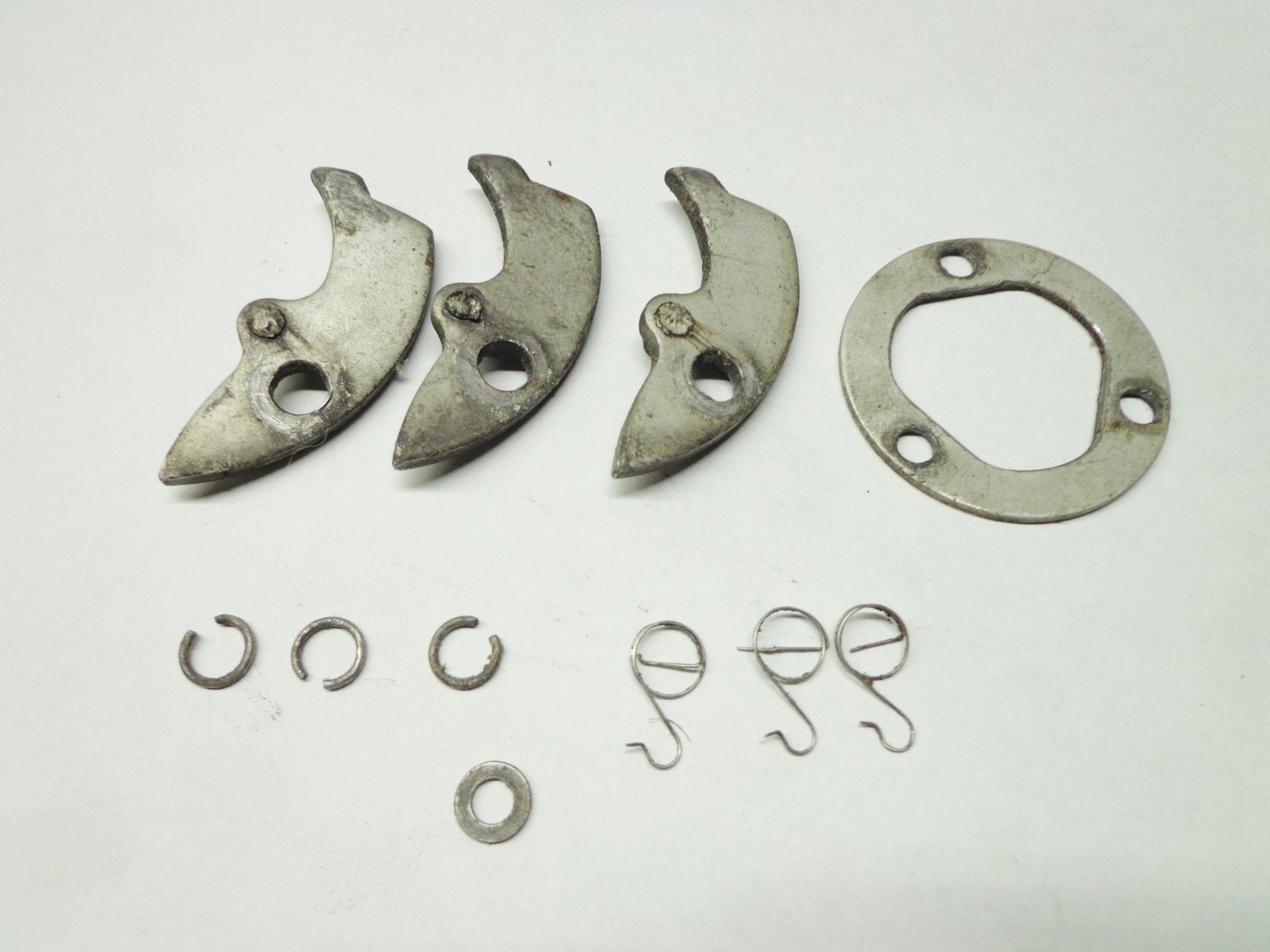

      I finally found the long lost parts for my HA-10 starter but not sure about them. There was one flat washer included but should there be three of them and how do the parts stack up? This motor was apart when I got it so I have no record of it.

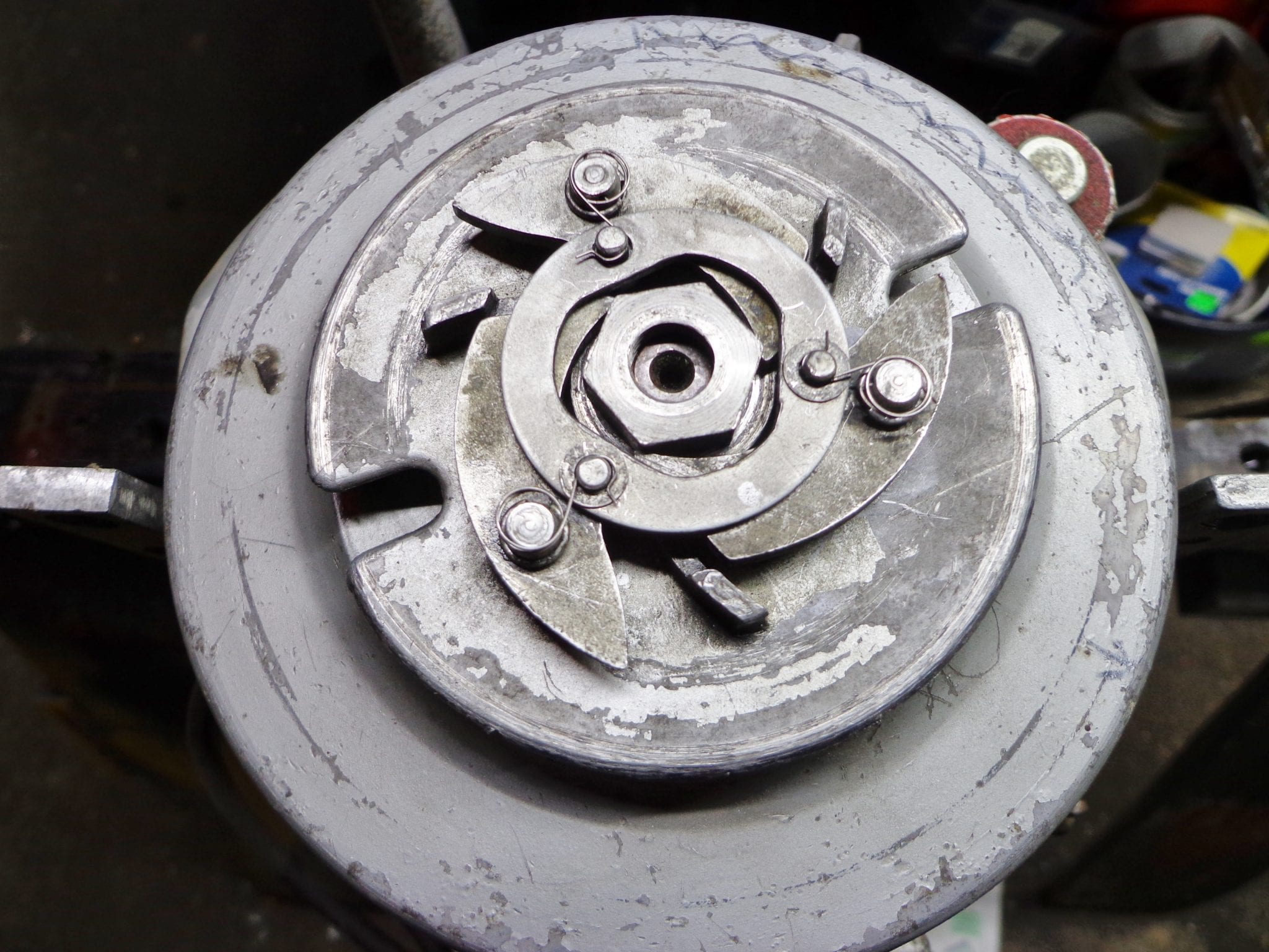

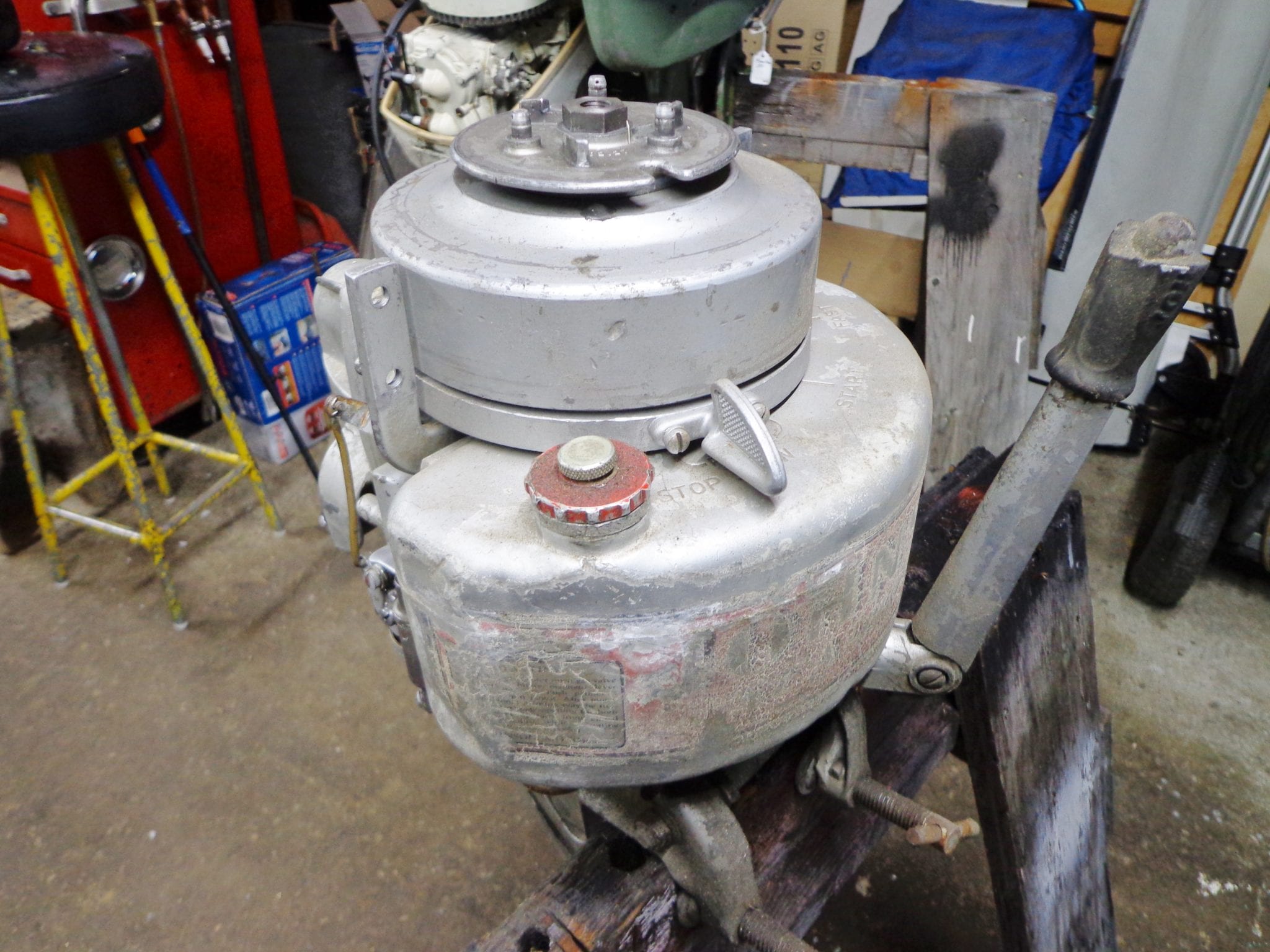

        It’s OK. I figured it out and it ropes over good now!

              Mumbles, those pawl springs will fair better if the tag end that goes though the large post goes over the top of the coiled section of the spring. Then the tag end can be bent downward slightly to retain the spring. This will help prevent uncoiling and give a longer life to these delicate springs.

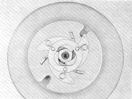

                Yeah, I was wondering about that after I put them on. Something didn’t look right. I’ll get them on the correct way when I take it apart again as Tubs great diagram shows the thin washers below the ring, not on top where I placed them. Thanks guys, all good information!

                    Nice looking HA-10! And yes, the thin washers go under the large ring so that the ring will not rub against the pawls as they move.
