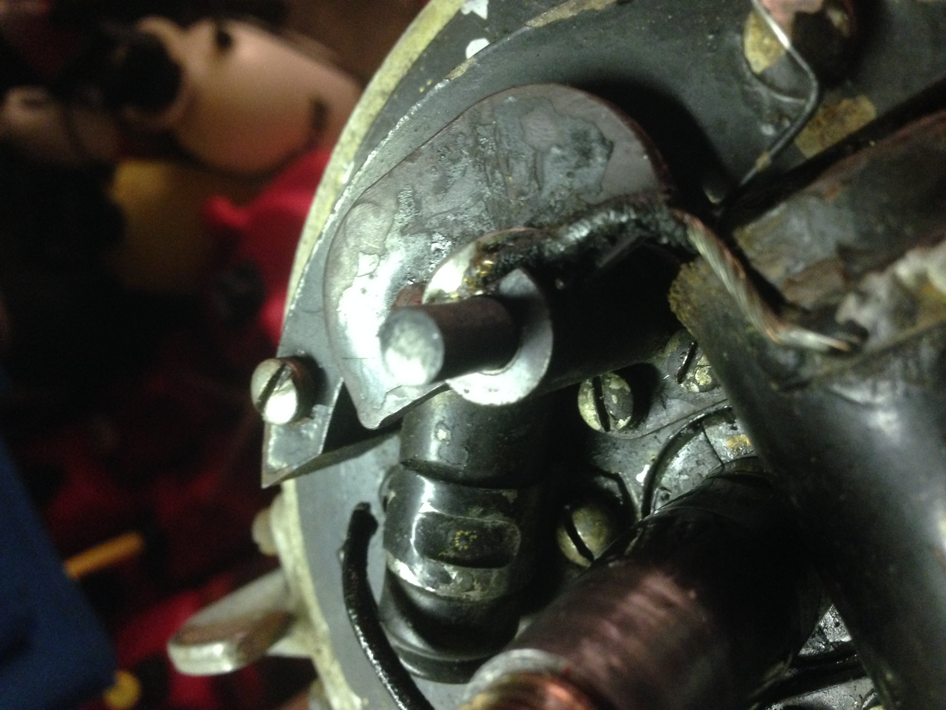

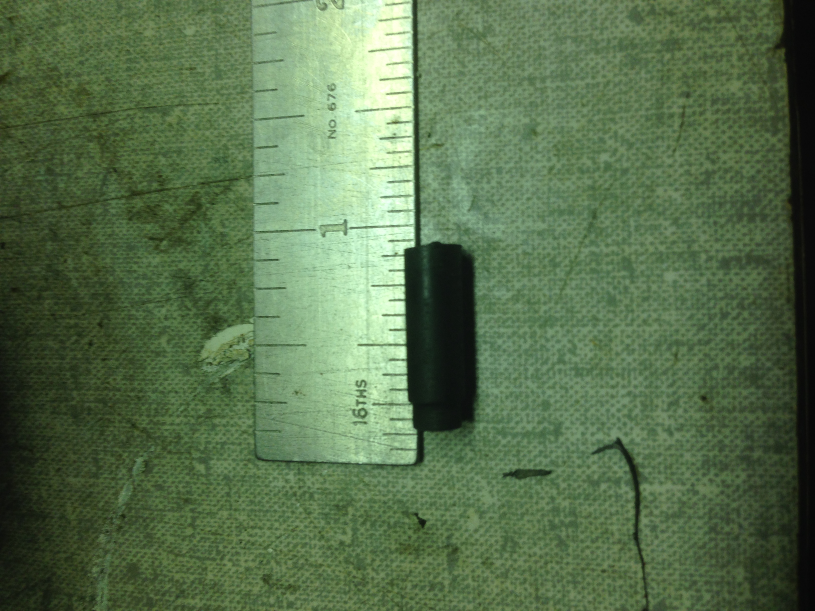

              ๐Ÿ˜€ thanks for all your great advice made a lot of progress today on the motor , A few more questions , on the magnetos there is a spring loaded pin seems to rub underneath the flywheel like an electric motor brush on the Armature what does that do? and I am missing one does that have conductivity? Is it possible for me to make one ? The lower unit has a fill and drain plug most people suggested using grease it does have a gasket should I use grease or lower unit lube?

                Pictures of magneto and Pin

                  those 2 spring loaded "pins" are brushes and yes they have conductivity and you really need them both. You might be able to make one if your handy,i’m not positive what they were made out of now,maybe delron? Did you check for spark and if so was it only one side that had it? Is the spring still in the pin socket? I’d be using the lubriplate 105 grease in there instead of reg. lower unit lube if it were mine. I pulled the carb gasket template sheet out today if you still want a copy.
                  #34630
                  Leon
                    Yes, each pin services a cylinder, as far as spark delivery.

                      Yes I surprisingly have spark in both. Cylinders. The spring is still in the Magneto i can easily make a a pin as soon I find outt what it’s made of? Thanks you said delron maybe? Also will use 105 lube in year case, yes please send the gasket patterns ๐Ÿ˜€ thanks

                        I need your address to send out the gasket sheet,havent got your pm? And yes I was thinking delron would work.
