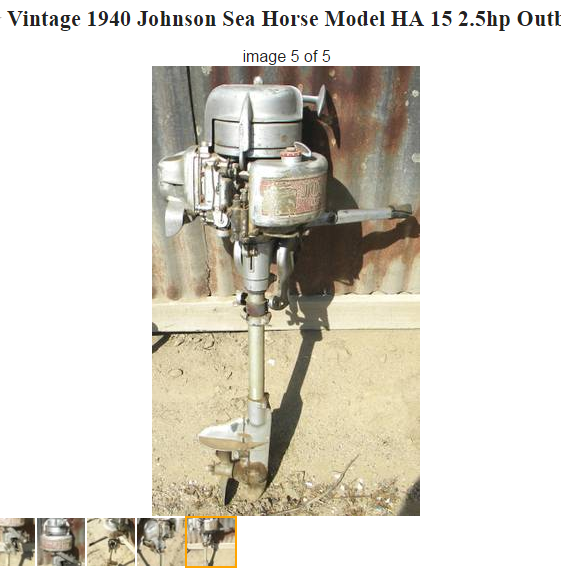

Hello to all;
I’m currently attempting to lowball a local CL seller on this old Johnson.I know not one thing about this particular motor, except it looks interesting. I don’t have one of these!
What can y’all tell me about these?
Any consistent design flaws? Any quirks, or negatives?I’d probably just dump tons of money into it, and maybe run it an hour a year. So, I’m not looking to cross the Atlantic or anything.
Any info, and all opinions welcome.
Many thanks, and happy motoring!
AlanOctober 22, 2016 at 5:13 pm #46310I don’t know much about them but I believe they were the predecessor to the post-war HD line of motors which were similar to the TD-TN motors but smaller.
October 22, 2016 at 5:43 pm #46316Mumbles is correct.They use the same carb as the hd,so in all probability you’ll need to buy some leather washers from a member and go to the Poche family website for directions.(you can do all the carb work without taking the carb off the motor.Taking it off is a pain.They are fun to use and pretty strong for their small size.
October 22, 2016 at 6:04 pm #46321Looks like a pretty nice unmolested motor, even a bit of decal remaining, I’d say go for it!

October 22, 2016 at 10:31 pm #46332Take a compression test. It doesn’t take long for those small pistons to ware out with cheap oil. I have seen one that would only run without a propeller. It was 48 on top 45 on bottom. Should be 65 or higher. . . 😉
October 24, 2016 at 4:52 am #46402It looks like a AT-10 1940 I had.

October 24, 2016 at 2:35 pm #46411That motor looks to be in very nice condition. I think most of these were used and abused quite a bit, as nice originals are not very common.
I recently picked up an HD-15 in decent shape.
I had been looking for one to go with my DT-10.
You will find the magneto/points system to be a bit unusual, with brushes and springs that wipe the inside of the top of the flywheel to create spark.
After I had figured out mine was missing the brushes, it has a great spark.
Good luck with it, I would pick it up in a heartbeat!October 25, 2016 at 12:50 am #46428I thought the system was ingenious. They use the same ignition coil as the apposed twin, but it is only firing one plug so the spark is twice as intence. There is the extra expense of two extra magnets in the flywheel, but it is in almost perfect balance. The wiper shorts out the plug you don’t want to fire. The down side? When you do a tune up and are cleaning and adjusting the points – you also have to clean the inside of the flywheel. A second modern charging coil and rectifier could be installed for lights or accessories. . . 😆
