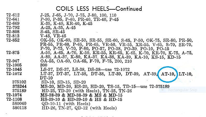

      Greetings all, I have a 1940 Johnson HD 10 that needs a coil. Are there any swaps with newer (mid 1940’s) coil/stator arrangement that would work? Or does anyone have a coil of that vintage available? Thank you.

        Not sure if this will help. Member Mumbles posted this a while back. Disregard the blue highlight
        Coils-Less-Heels
