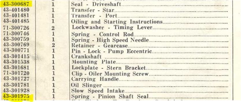

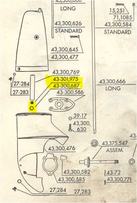

      Engine is leaking gear case lube up the drive shaft. grease leaks out just below the power head. When I disassembled the lower unit and compared it to a service manual, mine is missing the drive shaft seal and spring numbers 43-301,975 and 43-300,687 Does anyone have information about the seal and spring, like dimensions or current part numbers.

          301975 spring and 300687 seal were both good numbers in 1964. 301975 was 5 cents and 300687 was 20 cents. Going to marineengine today, 301975 is NLA and 300687 is $3.50 and they call it a “boot”. Don’t know what to make of that.
