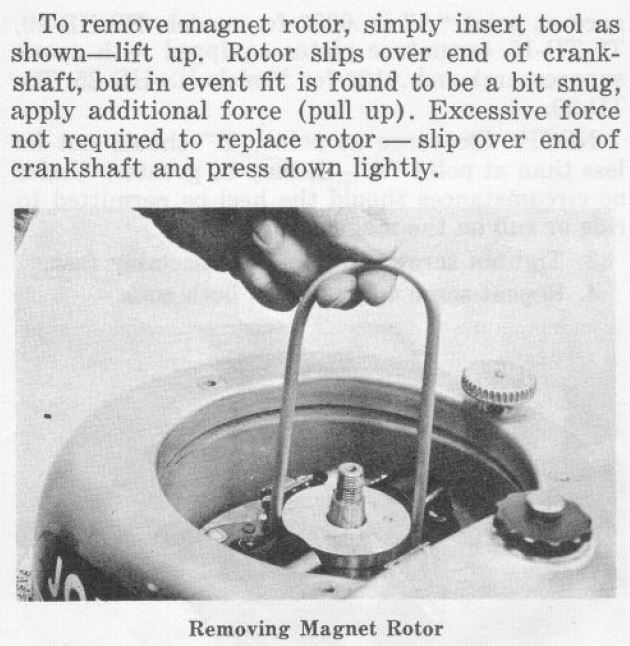

      #78367
        Magnet has to come off first. There actually was a special tool for that, but I never had one, nor needed one. A gently pry on both sides with a couple of screwdrivers to rock it up and off usually does it. Now, if it is corroded on there, that is a different story.

          Frank is right, the magnet will come off with careful prying. Before you go much further, the coils and condensers on these motors are many times still good. You may be able to just clean and reset the points and get good spark.

          #78379
            Book sez lift it off and if it seems tight, pull harder. πŸ˜‰ πŸ˜‰ πŸ˜‰
