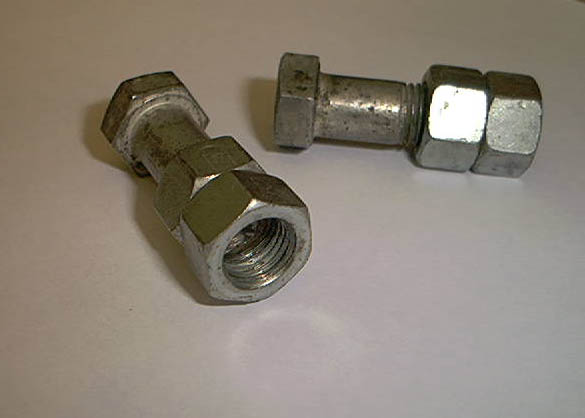

                  Well ok, time for back to basics.  Do not hammer on the flywheel nut, which probably damage the shaft threads.  Use a flywheel knocker.  It will remove it without damage.  You can buy them, or make your own for less than a buck.  Find two nuts, same thread as the flywheel nut, and a short bolt, the shorter the better.  Screw one nut onto the bolt, then the other one on only a couple of threads.  Run the first nut down to jam against the second one.  You have just made a special tool.
                  To use, hand tighten the tool onto the shaft.  Lift or pry the flywheel upward.  Give the tool a rap or two with a hammer, and the flywheel will pop loose.  Put the sledge away, and use a hammer 12 oz or 16 oz at the most.  It is the shock that does the job, not the bash.

                    The flywheel nut looks to be threaded all the
                    way through. If that is the case and its not too
                    beat up from being hammered on previously
                    you can use it with a bolt as in Franks method.

                      I knew it was something simple. Thanks for the help!
