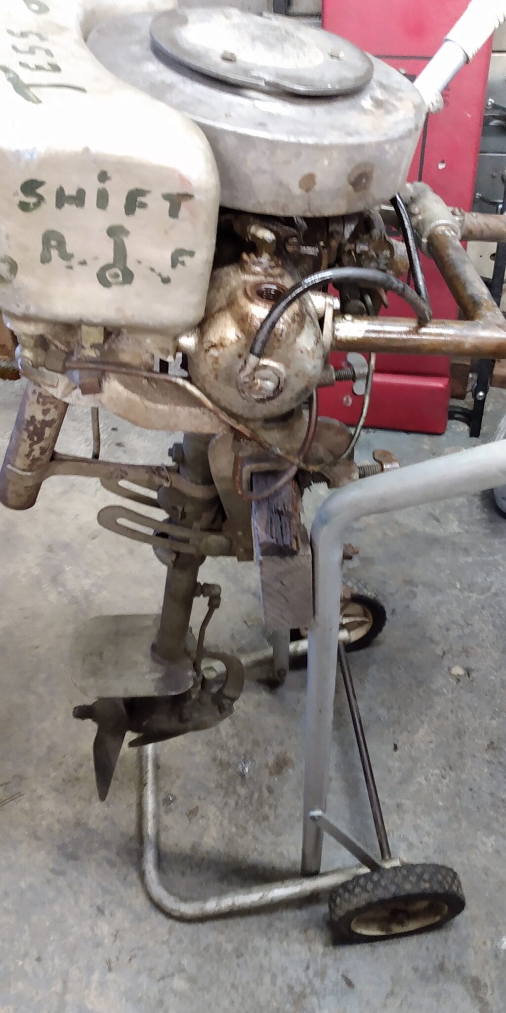

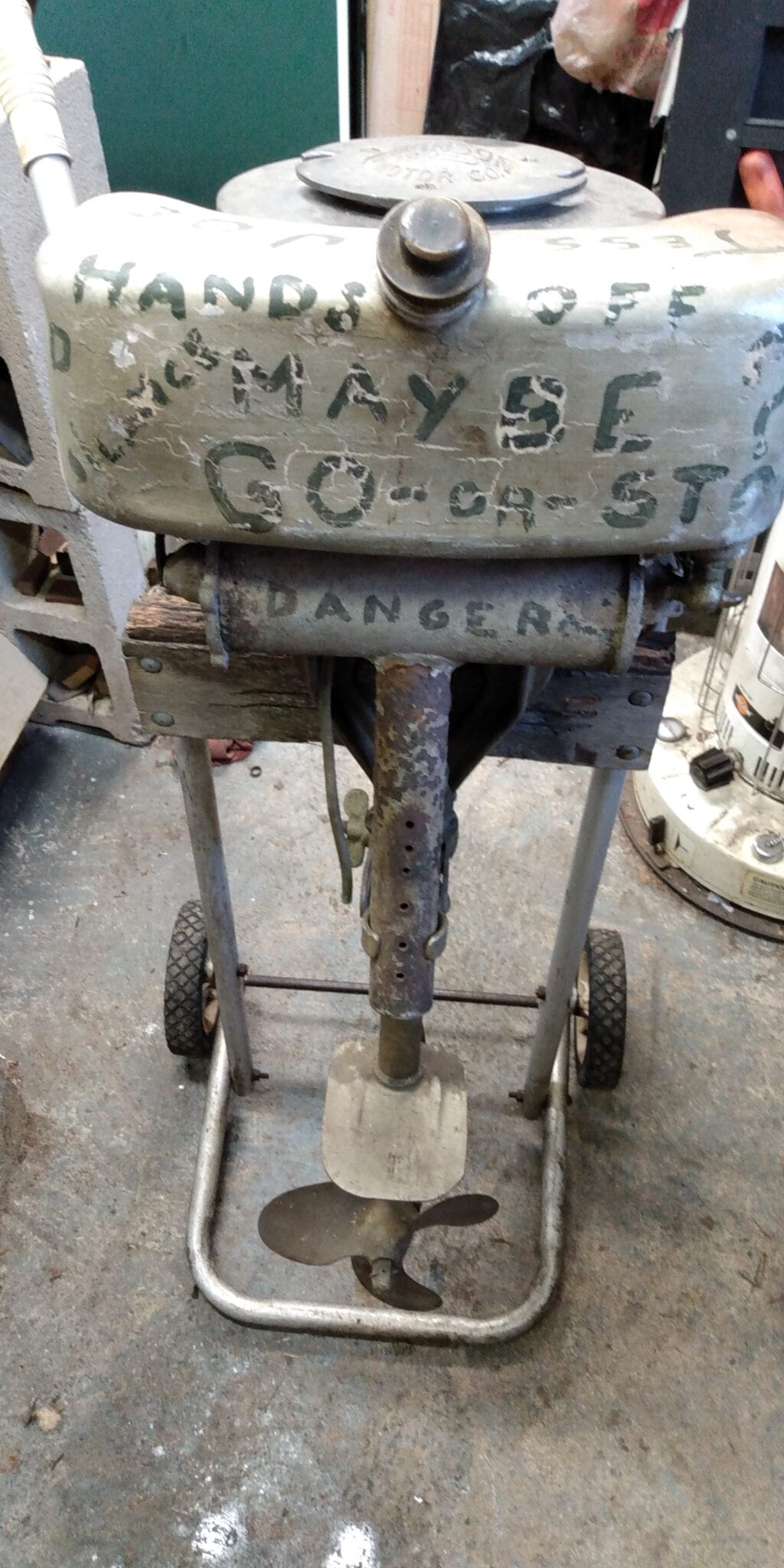

      Hello, just picked up this motor. Seems to be in decent shape.numbers on flywheel are – A 10380. Looking for year,spark plug number,point gap, and any other possible info. Thank you

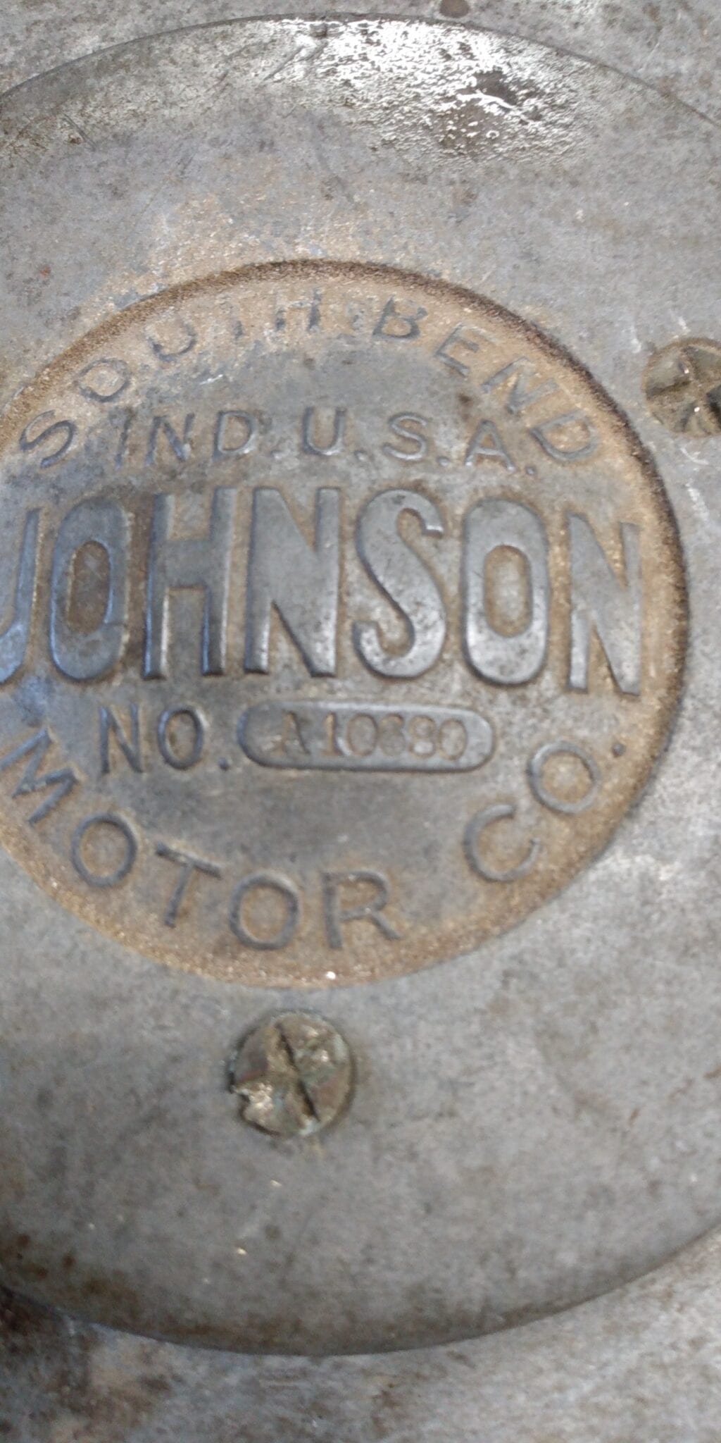

        1924 is the year. I have one about 650 motors before yours it was my first old motor that got me into collecting them. Great motors. I now have several. Pm me when you have a chance. D9J is what plug is called for. I would have to see what’s in mine. I believe I have been able to clean up what we’re in mine when I got it and they worked fine

          From your picture something does not look right with your exhaust

            It also has a 3 blade bronze or brass prop. Not sure if thats right. i got it to turn over easily . I cleaned the points and it has spark

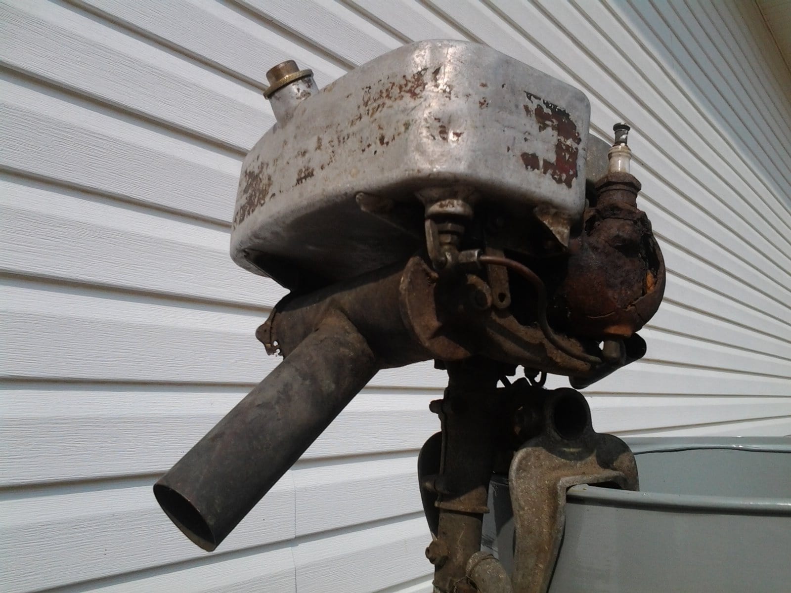

              This ’24A has a similar modification.

              mike n
                Does it really make any difference??

                  It does have character. And yes it originally had a 2 blade prop. One of the early modified cottage racers love it
                  #234533
                    Looks like a previous owner has a sense of humor!
                    Only problem, does one leave the graffiti on the motor
                    and preserve it’s prior history?
