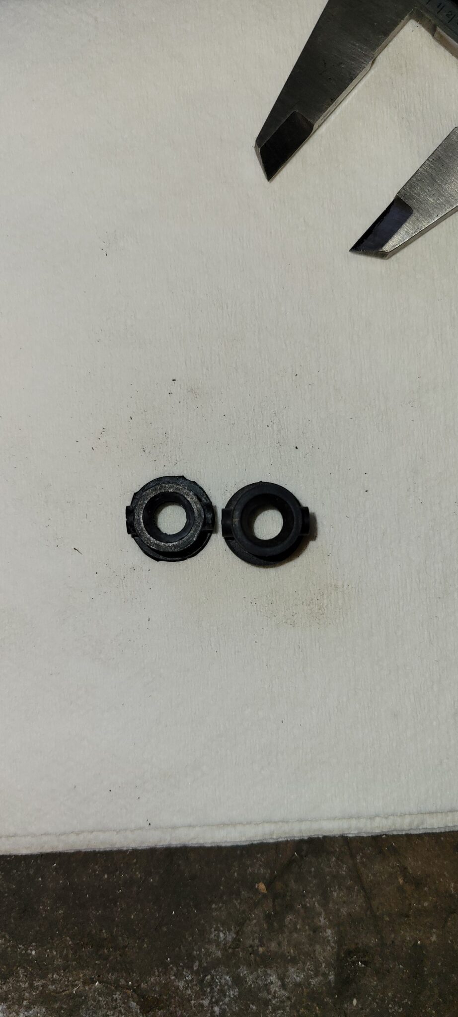

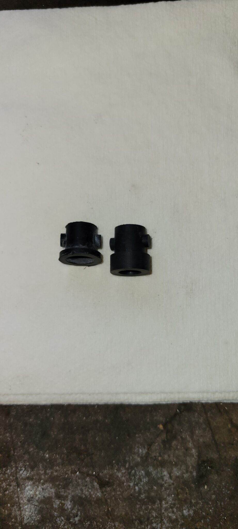

                  #254419
                  mike n
                    317372 is on left. 205572 on right. They look the same size. Outer and inner diameters are only a couple thousandths different. The flat part that seals against the surface of lower unit that folds is 5/32 thinner on 317372. Maybe you can find a 5/32 piece of rubber to cut out and glue to it. Not sure what kind of glue. Maybe another member can give advice. Maybe super glue,weatherstrip adhesive,marine silicone. Just a suggestion. Good luck
                    20220211_120029
                    20220211_120111
                    20220211_120214
                    mn

                    #254428
                    neps989
                      Thank you for the pictures and the information. After seeing what the part looks like along with the information you provided, I am sure I can make something that will work.
