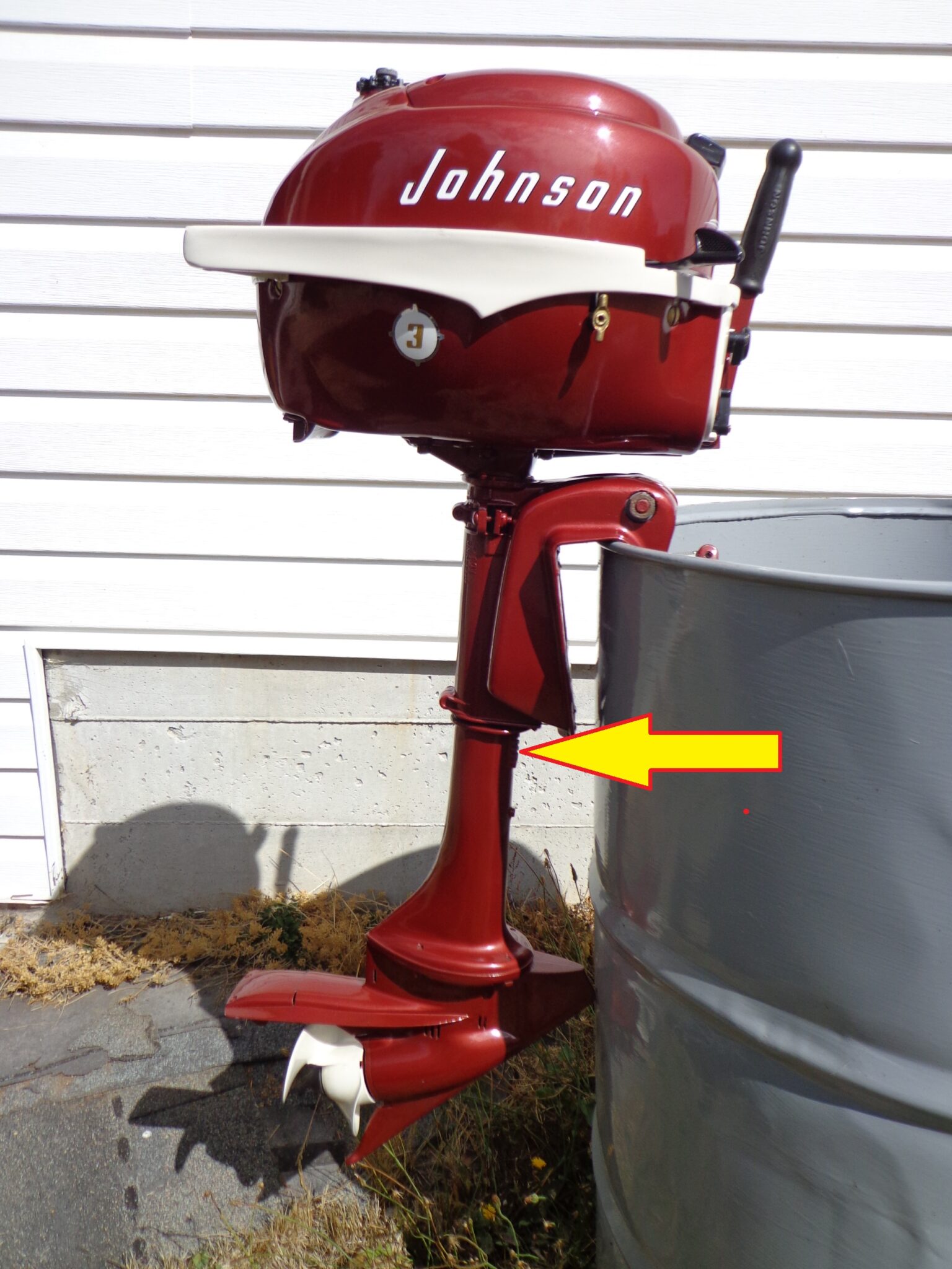

I finally got my jw-17 3 hp outboard running. it has been sitting in my shop for the last 40 years. How can i tell that the water pump is cooling
the engine? I checked impeller and it seems to be ok. Want to make sure i do not overheat engine. thanks
March 13, 2022 at 7:18 pm #256197If the impeller is 40 years old, it should be replaced no matter how good it looks. After sitting for that long, it will only be a matter of time before it falls apart and you probably wont notice the motor overheating because of it.
These three horse motors have the water outlet incorporated into the idle relief port on the front of the exhaust housing and it is covered by a small plate. It’s hard to see the water coming out as it can be a spray or a dribble. The best thing to do would be to replace the impeller as part of a preventive maintenance program and invest in a cheap infrared thermometer. The IRT can be used to scan the running motor while the lower cover is removed.
March 13, 2022 at 7:40 pm #256203Thanks for the advice. I am getting a new impeller and a IRT. One more question. What temp range should this engine operate at? Thanks again!
March 13, 2022 at 8:55 pm #256206You can find temps all over the scale, depending on where you check. Exhaust cover plate and right around spark plugs are the hottest because they are not directly water cooled. Also, lake water temp and engine speed are big factors.
March 17, 2022 at 1:37 pm #256389Like Frank says, these engines can be tough to check cooling wise because they run at very different temperatures depending on where you check. The exhaust cover and head will be pretty warm/hot for the reasons Frank mentioned. Usually, the temp is checked on the starboard side of the block near the ID core plug. The engine shouldn’t get hotter than 165F at this point.
There should be a very fine spray of water/mist being expelled from the area that Mumbles pointed out.
March 19, 2022 at 5:51 pm #256492Thanks for the good advice. I installed the new impeller and ran motor. I checked temps with IRT and all temps were fine. thanks again. The only thing i need now is to find a front handle.
