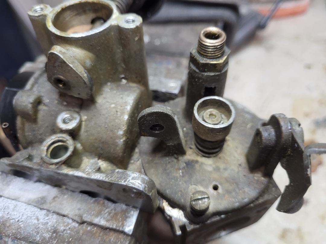

      I have a light four that needs the carb cleaned. I am trying to remove the cover over the float bowl but there is a spring and “cap” of some sort preventing me from taking it off. I have attached a pic. How do I get this cover off to get access to the float bowl.

      #268770
      Tom
        Unscrew the brass plug at the bottom of the carb and hold a dowel or pencil in there to keep the float pin up.  Then push down on the outside cup to expose the pin holding in the retainer.  Slide the pin out with pliers, and watch for flying parts.

        #268775
        huntleybill
          Thank you Tom. After removing the pin, the retainer still would not come off.  With the use of a needle nose pliers I was able to pull up on the retainer removing it. Unfortunately, it broke off the very tip of the needle.

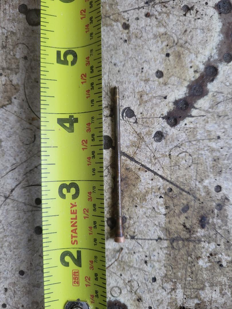

          #268780
          Tom
            The retainer must have been really stuck.  Measure and post the overall length of the float pin before it broke, maybe we can match something up.  Or someone will chime in with some Lightfour parts.  I don’t know if the pin is the same as the Zephyr.

              #268789
              huntleybill
                The needle is 2 1/2″ long. Below is a pic. Looks like I will need one. Can anyone provide one?
