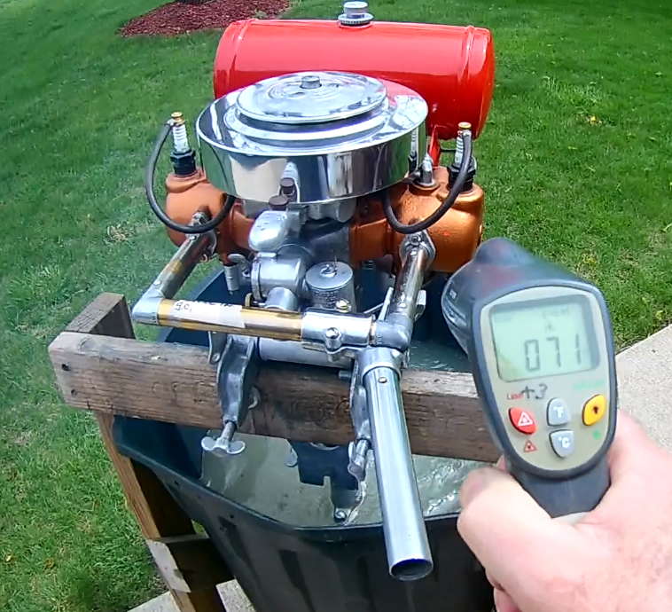

          Another option is a laser  temperature gun . They can be found for around $10.00. They’re not super accurate. Mine seems to be about 3 degrees low but its close enough for my needs.
          Gun
