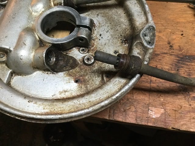

              squierka39
                I got lucky I guess. These just screwed right out. The rubber parts were stuck to it though.
                D7AD23F7-18CC-433F-A8A9-93ACA67881BF
