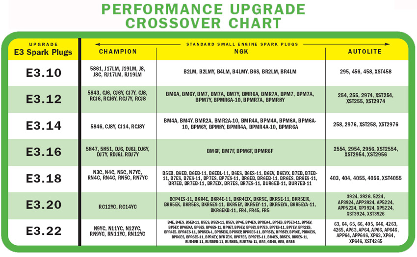

          #42745
            This chart might help as it shows the NGK equivalents. ☺
