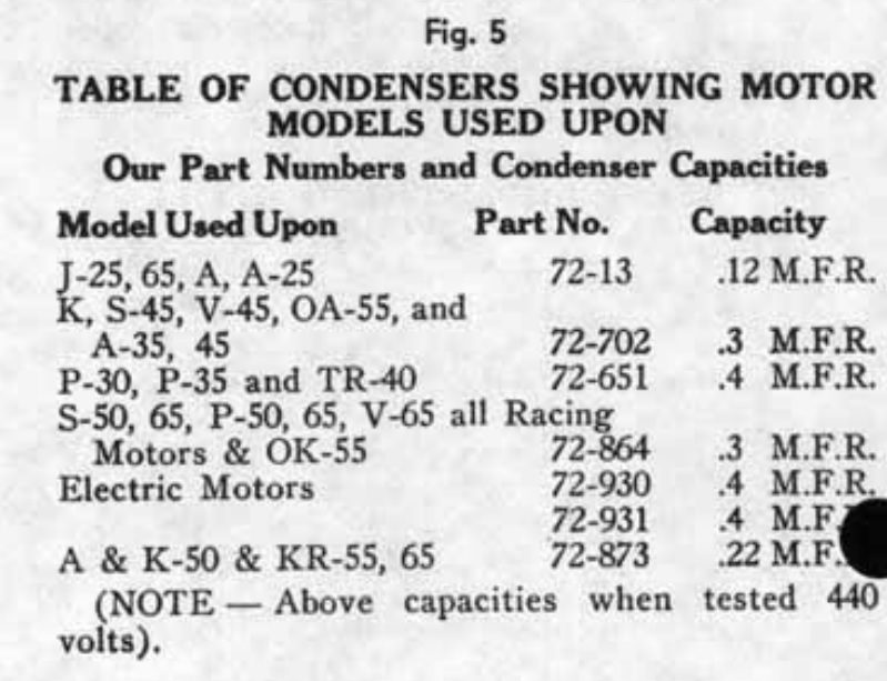

      Hello, does anyone know of a condenser i can use in my 1924 johnson model A. Thanks
      mn
      #292450
        Here’s a chart
        Eary-Johnson-Condenser-MFD-ratings
        #292452
        Mike Natoli
          Great! I knew i saw that somewhere. Thank you. Is there an off the shelf condenser that i can use

                      there is a relationship between coil and condensers but te critical aspect seems to be moreĀ  magnetism generatedĀ  Ā andĀ  it’s impact on the coil windingsĀ  not to mentionĀ  protection from arcing across points.Ā  Ā  Ā trial an error I guess with your new set up using modern coils on older magnets
                      but m. Mohat seems to like the middle ground using .22 uf
                      Joining AOMCI has priviledges šŸ™‚
                      #292609
                      GARY
                        This is from series of Antique Outboarder articles (written by Bill Mohat) concerning testing and selecting condensers.I run .22uf and higher in my early A models
